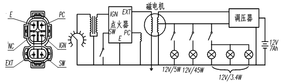

Does it have part number printed on it? For sure it's not non-standard. Check it it's AC or DC (most probably it's the former), and then check your connector, e.g. 4 pin, round one.

Most vertical chinese uses 6 pin (round OR square) CDI:
AC
http://www.sanxin.com.cn/images/p-2-3.gif
http://www.sanxin.com.cn/exhibit/upl...8522499844.jpg
DC
http://www.sanxin.com.cn/exhibit/upl...1305739717.jpg
http://www.sanxin.com.cn/exhibit/upl...1305020639.jpg
How 2 check
http://www.sanxin.com.cn/info5/index.asp?id=16
http://www.sanxin.com.cn/info5/index.asp?id=14
http://www.sanxin.com.cn/info5/index.asp?id=20
Older bike's EXT (source coil) often F***ed. Most chinese street mechanic just install a UNIVERSAL DC CDi http://item.taobao.com/item.htm?id=38711768895 (Extra wire = +12V | Connects that wire to (+) source that are turned OFF as the key s/w position, otherwise it will drains the battery flat ) as quick fix.
