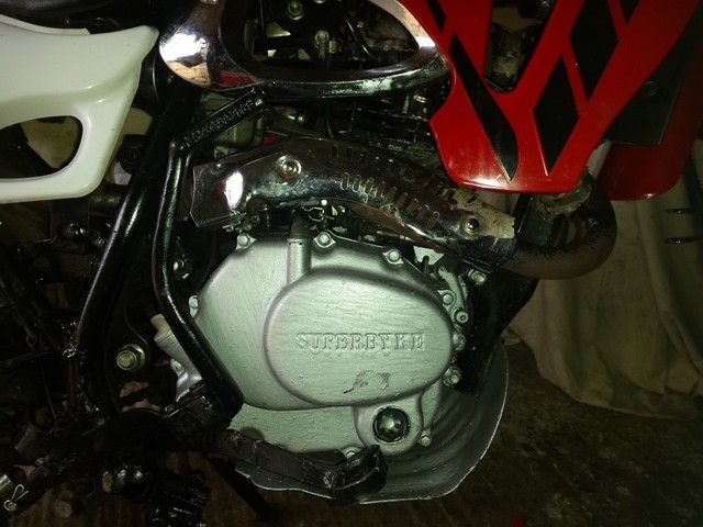

Il get some pics etc and post here as well.

Its a ZD 15T that is on the front at the moment. waiting on a stand to come so I can remove the rear wheel to get the rear cog off.

http://i7.photobucket.com/albums/y27...psudfjmked.jpg
http://i7.photobucket.com/albums/y27...psghxnztie.jpg
http://i7.photobucket.com/albums/y27...pse7lg8onr.jpg
http://i7.photobucket.com/albums/y27...psxi1db3fk.jpg
F: Powered by CG125 clone http://www.jtsprockets.com/catalogue/sprocket/JTF259
R: Unsure
http://www.jtsprockets.com/catalogue/sprocket/JTR269 or http://www.jtsprockets.com/catalogue/sprocket/JTR810
Thanks for this.
Ive sourced the front sprocket with the sizes as you posted, looks spot on. soon as it comes il post pics and a small video. :)
Well job done CG sprocket was spot on, thanks for your help. Had to adjust the sprocket bracket so see why in the video. Not a huge change but slight increase in power is clear, better at going up hills now than before, Hope this helps others.
