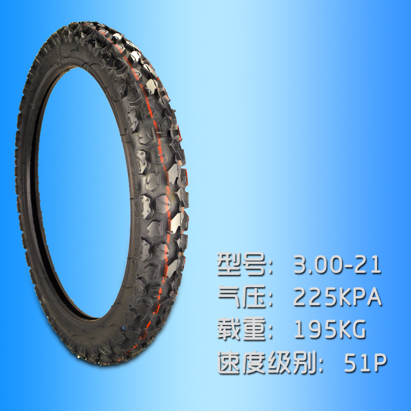

Re: Shineray / XinYuan X5 review
Invest in a tried and tested set of tyres from a mainstream manufacturer.
Or go with the set posted and hope you make it through the day.
370 RMB sounds like a great deal.
But you can understand you "pay peanuts you get monkeys"
Your Bike.
Your money.
Your life.
Ride safe.
prince666
Your Bike.
Your money.
Your life.
Ride safe.
Its not that I want to save money, I simply cant get here what I want.
Can get Pirelli that are 90% dirt but Id imagine they are worst on road than this ones. If I could get a 50/50 good brand tyre I would
So you are saying money is not the issue?
Then ship a good set in from the UK.
Well if I have to may 200% of the original price it might be an issue but even if I wanted to, its illegal to ship tyres internationally....apparently. Most shops wont ship tyres. Id have to ask friends or family and even then I dont have a guarantee they will reach me. too much hassle if you ask me ;)
There is a set of Weerubber tyres in taobao for about RMB850. They are not ideal but I might end up buying those
modron
Well if I have to may 200% of the original price it might be an issue but even if I wanted its illegal to ship tyres internationally....apparently. Most shops wont ship tyres. Id have to ask friends or family and even then I dont have a guarantee they will reach me. too much hassle if you ask me ;)
It's called Vee-rubber made in Thailand.
A lot of the bike rental shop who rent out CRF use them but I am told not great in the wet?
But I still think there are better than the set you posted.
ShuBen
I was quite satisfied with the Kenda tires. Just the wet grip is performing bit lower.
I used it for 10k km All terrain travel.
Only thick mud is closing the profile completely, but for that condition u need knobbis anyway
I had a set fitted to my Yamaha YBR been happy with them. (set of Knobbis)
Them Kendas are ok on the road but slide a lot off-road in wet and I live in a very wet area.
Here are the Veerubbers, https://item.taobao.com/item.htm?spm...u=t2dmg8j26111
the size is not ideal but I hope it will do
