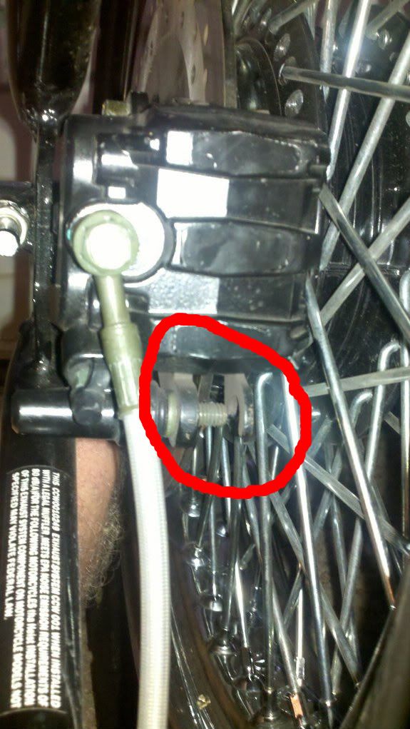

there supposed to be something on this bolt? my rear caliper is loose and i believe this to be the culprit..... my front caliper has a sleeve thats threaded on the inside, looks like its to keep the caliper from moving around or something... im confused.http://i717.photobucket.com/albums/w...t_60849_-1.jpg
there is supposed to be a barrel nut there on the front and the back. Contact your dealer and he will send you a new one. Add some blue locktite to it when you get it. the bike is alright to ride that way but get the barrel nut on there.

awesome. im curious if i could find something at lowes or somewhere to put there..... i contacted brett and al from pit, but i don't expect them to do anything, just basically asked them if they knew if something was supposed to go there. but then i remembered this thread and thought i would try my luck here too. great help as always gardo.
Yea Al sent me one out the next day after i notified him shoot Al an Email, alan@pitmotorsltd.com, Brett tends to get inundated daily with emails.
They stock all the parts for the bike so they should have it to you in no time :thumbsup:
yeah, i've hit them up 2 times now for different parts and they've been amazing about it. just don't want to annoy the hell outta them with every little thing...
MK2 that's what they are there for man. they get it, they are car and bike guys.
we'll see what they say when they receive the e-mail then. and as long as this won't hurt anything i am going to continue to ride the bike. not sure when it fell off, so i have probably gone a while without this. hahaha things happen i suppose
