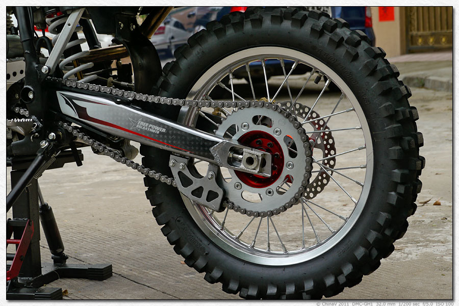

Not nice to fool your fellow China bike riders. That's a new bike that has never been ridden, now show us your real bike that you rode in the rain for 1300kms.
The TGR after 850kms offroad... I told you, I'm not right in the head when it comes to dirt on my bikes. :crazy:
