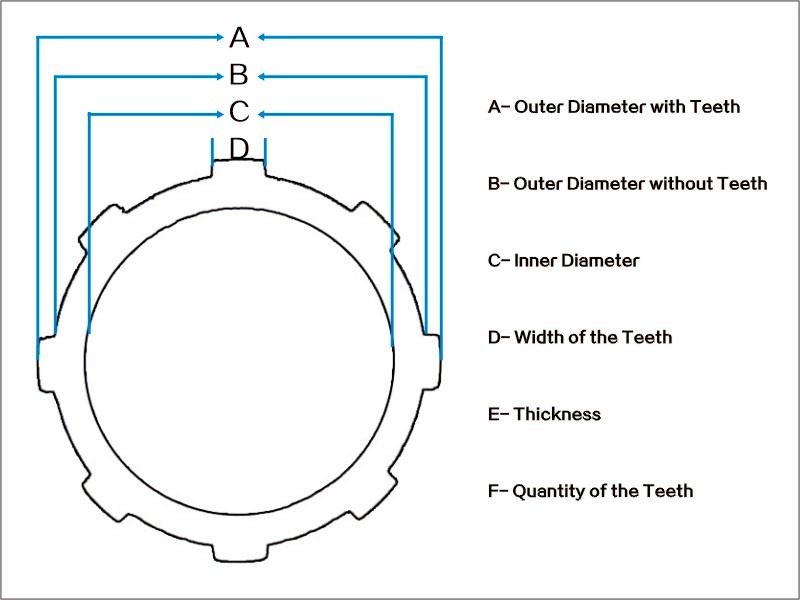

Wear limit :2.6mm
http://imgs.inkfrog.com/pix/lupumotoparts/8Teeth.jpg
A= 119mm B= 110mm C= 91mm D= 15.8mm E= 3mm F= 8
