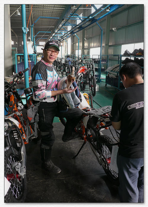

I stopped by the Galaxy factory last week to order up some parts and gawk at frankis new ride. They've made some nice changes to the bike, but I'll let franki cover that later when they finish everything.
Here is the XTR Adventure/Rally/Franki edition. Galaxy already had a good start on this with their Taklamakan bikes, coming along quite nicely I think.
http://www.contactdi.com/2009/galaxy/XTR016.jpg
Franki and friend pose for a photo op.
http://www.contactdi.com/2009/galaxy/XTR017.jpg

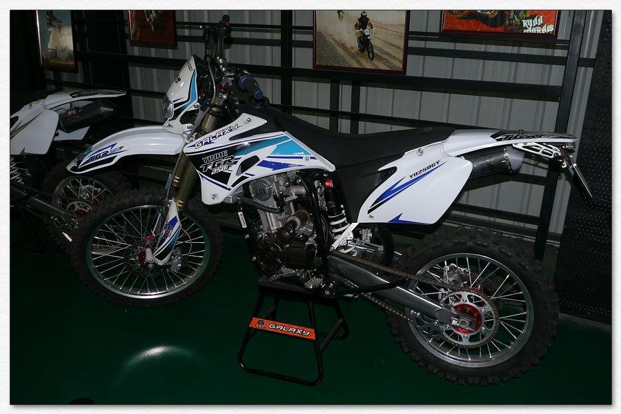

Andy, I didn't see your bike, but Lydia said they are working on it. Interesting to note that yours will be fuel injected, I guess they have to do that to meet emissions in the UK.
Wish this one could be registered in China.
http://www.contactdi.com/2009/galaxy/XTR018.jpg

Hmm fuel injection eh ? Hope that won’t over complicate things ?
I notice on Franki’s bike it has what looks like an up rated red rear brake pedal...do you know if that’s standard on the new bikes now, or an upgrade specified by Franki ?
I really love the look of that TGR 250 as well , it wasn’t on their website when I placed the order for my XTR, if I’d have Known about it, then I would have ordered one instead of the XTR...oh well, never mind :rolleyes1:

Nice to the see the racks on there with the extended tank. Couple of comments though...
1) Are they going to level out the rear rack?
2) How about widening the last 3/4 of the seat?
3) The saddle bag standoffs may perform better if they are several inches forward.... 2 main reasons being better weight distribution/mass centralization and less danger of the exhaust pipe hitting any saddlebag material coming over the rack.
4) Does the alternator have enough output for auxiliary lighting?
5) Much of the extended range fuel tank looks like it's below the carb/fi unit. Is there a fuel pump on the bike?

Andy, they do have special CNC brake and shift levers, the price was around 30 USD each, I tried to get some, but the red ones are out of stock at this time. You could buy the TGR for motocross, but it can not be registered in Europe yet because of emissions. I think the air cooled is a much better choice for reliability at this point. No idea about the FI, but a small single cylinder engine should be pretty easy to dial in the FI. On the good side, you won't have to worry about re-jetting for those massive 5000 meter mountain passes in the UK :lol8:
CrazyCarl
It levels out a bit when the suspension compresses under load. As far as I know, the boys will be using soft luggage instead of hard cases.
The seat is a little different than stock, but still pretty narrow for touring. I bought an extra and intend to make it wider, I have seen some nice DRZ400 seats that look good for touring.
I don't think they will have any problems with the exhaust, but you're right about the position. Unfortunately the bike is so short in the seating area there is not much room to move things forward.
Franki said they boosted the alternator, I'm going to try and get one today.
Yes, the bike uses a pump.
