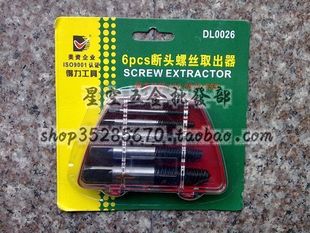

I bought a bidirectional drill yesterday but could not find complete extractor kit so I will bring a reverse drill bit and extractor kit with me back from either Europe or USA. If anyone knows where to get these in Shanghai or elsewhere in China, let me know.
All points bulletin! Calling Pfaelzer! He's got the best-stocked garage in China, and seemingly every tool under the sun....
Actually, there are tons of broken bolt extractor kits in Taobao. I searched for the term "broken screw" (断螺丝) and got MANY HITS
http://img04.taobaocdn.com/bao/uploa...pg_310x310.jpg
Your team in Nanjing should be able to source something useful....

Thanks, for the help. I could not find this in stock here among the local stores or the B&Q but we were told that they could be had. I was not so fortunate on the T-handle that clamps onto these so you can exert direct straight line pressure onto the top of the extractor while turning. I have always failed miserably trying to use an adjustable end wrench or something similar. A counter clockwise drill bit is my real secret weapon I am looking for. When drilled out with the counter clockwise drill and a good extractor with t handle is used used even my limited talent has allowed me success. All this being said, I had not tried Taobao to find this. Good idea for a starting place. Sometimes I do not see the forest for the trees, especially when frustrated. Thanks.

With regards to the bolt extractors (easy outs), have you thought about using the T-Bar handle from a socket set? I've got a great LUX socket set that has one with numerous adaptors, though I'm certain you could buy one as single unit in the tools section of B&Q (it's one of my fav places to shop in PRC - I feel like a kid in candy store). [The interesting thing is not all stores carry the same stock between one place and another, as I found out when I stopped in a B&Q store in Wuxi. It was like being in a whole other candy store. OK, off topic...]
Usually for such kinds of snapped bolts, I drill an undersized hole the length of the broken bolt, then using either a T-Bar handle or a small adjustable speed hand-held drill connected by an adaptor to the bolt extractor, seems to work fine for me. I've not had problems using ring or open-ended spanners though to get the easy out to bite into the broken/snapped bolt though. Maybe I just have a steadier hand?
