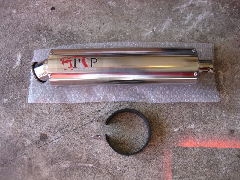

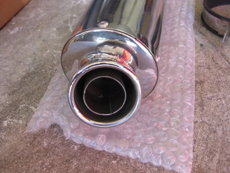

Well I got my exhaust and wanted to share some pics. It was a pain trying to get it to fit up right but I made it work.
Here is the link to the one I ordered off Ebay http://cgi.ebay.com/ebaymotors/Gy6-S...ehicleQ5fParts
I paid a total of $114.95
Here are some pics out of the box.
http://i86.photobucket.com/albums/k1...t/IMG_2647.jpg
http://i86.photobucket.com/albums/k1...t/IMG_2648.jpg
http://i86.photobucket.com/albums/k1...t/IMG_2649.jpg
I reused the rubber spacer from the stock pipe to move the clamp out from the frame a bit.
http://i86.photobucket.com/albums/k1...t/IMG_2657.jpg
I had to bend the back mount in order to keep it from rubbing on the pipe.
http://i86.photobucket.com/albums/k1...t/IMG_2658.jpg

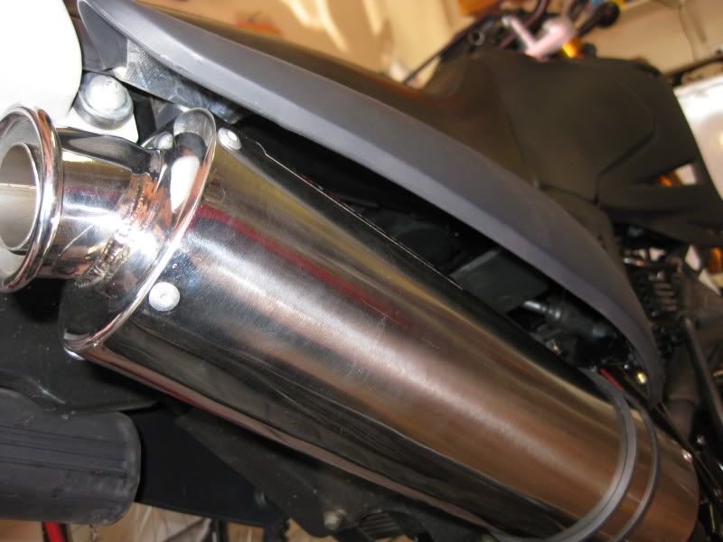

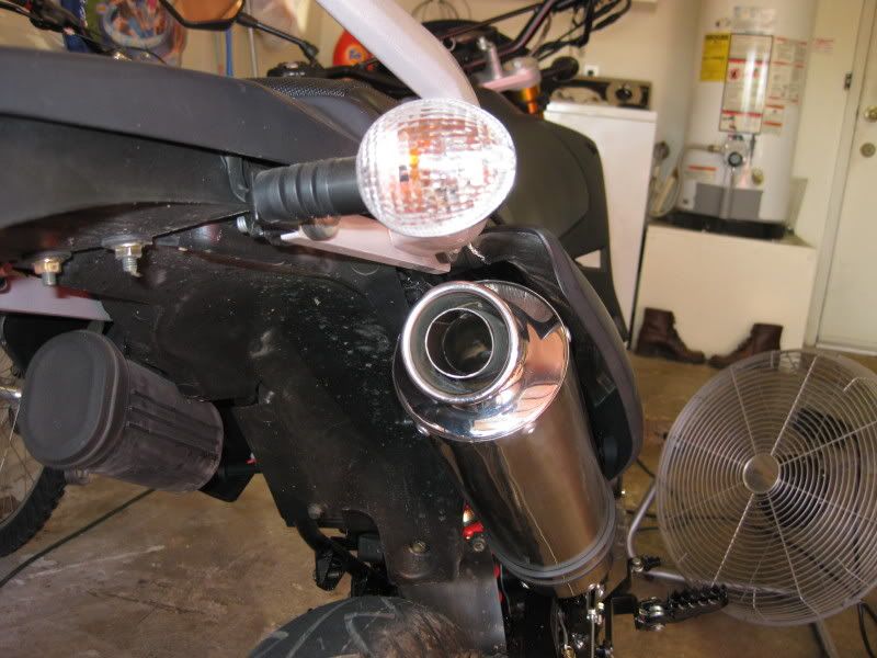

Here are some pics of it mounted up.
http://i86.photobucket.com/albums/k1...t/IMG_2656.jpg
http://i86.photobucket.com/albums/k1...t/IMG_2659.jpg
http://i86.photobucket.com/albums/k1...t/IMG_2660.jpg
http://i86.photobucket.com/albums/k1...t/IMG_2661.jpg
http://i86.photobucket.com/albums/k1...t/IMG_2662.jpg

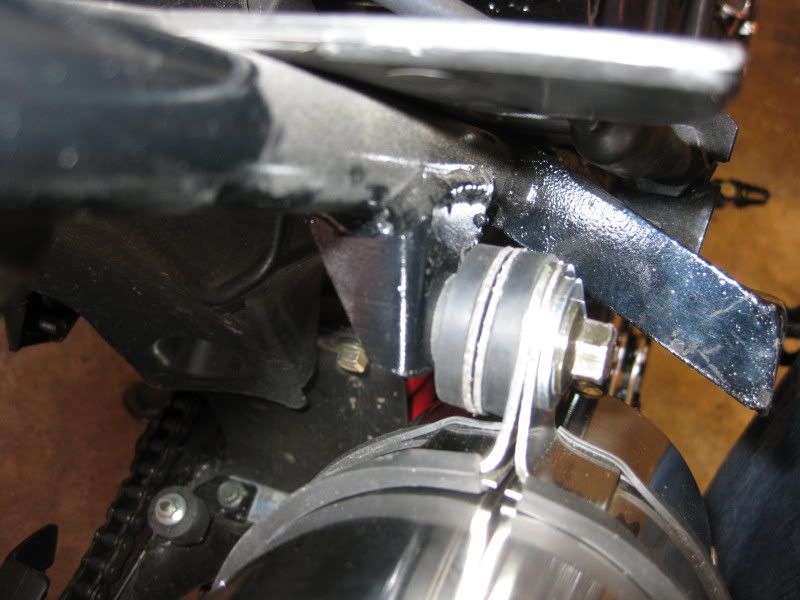

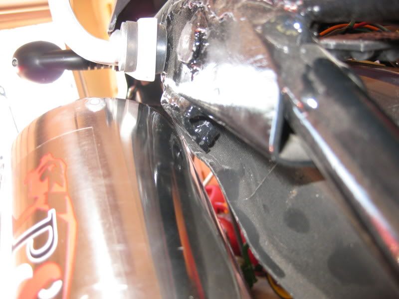

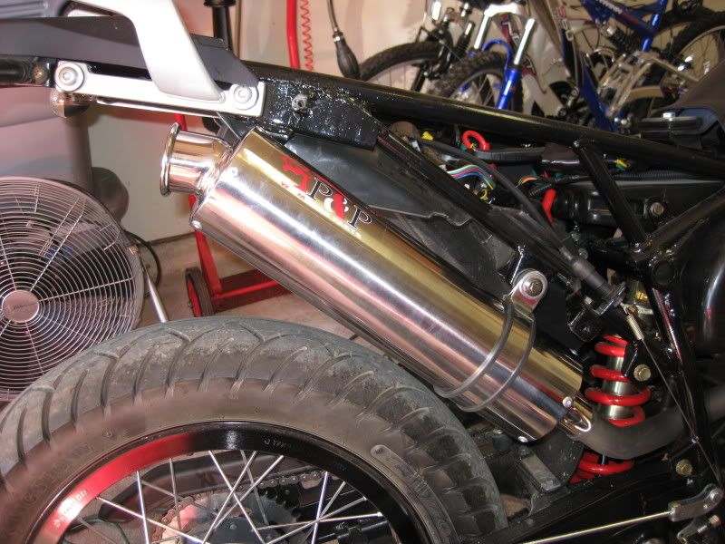

Ok, here are pictures of the exhaust I installed. Even though I am happy with it, and it was only $68 delivered to my door, it was a ton of work to get it to fit. I do not recommend the exhaust because of this. I can list the steps If someone wants to know what it took. It's longer than forchetto's and Matt's as you can see.
Man, that can is BIG :icon10:. Looks to be of good quality. The only other comment I would make is that it looks as if it could do with another strap a bit further up and anchored to the original exhaust's second mounting hole, next to the grab handle. This hole is visible in the 3rd photo.
It feels as if the vibration and road bumps might shake the can, and, being held so low down it may move a bit and strain the original downpipe.
forchetto, that's where I had it originally but it pushed the pipe too close to the swing arm. I could hear the pipe touching when I sat on the seat. Part of the installation (besides the milling, drilling, welding, painting, and swearing) was bending the completed headpipe assembly with a long pipe and wood blocks. I think that I might have enough room now to move the strap up to the top. I'll check it with a caliper tomorrow. It is a nice pipe for a great price, though. Just a lot of work.
