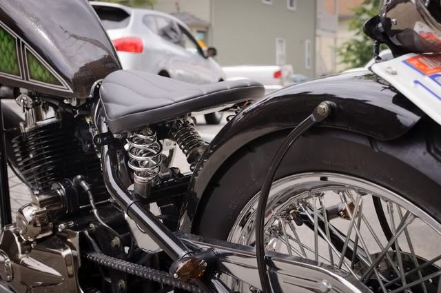

That's the seat I'm running. Big improvement. Though it is does have more padding, the slight kick up in the back is what makes it for me. Bolts right on using the stock brackets. Weighs far more than the CCW seat though.
Here it is with a test fitting of 3" traditional springs
http://i1090.photobucket.com/albums/...t/_DSC7981.jpg

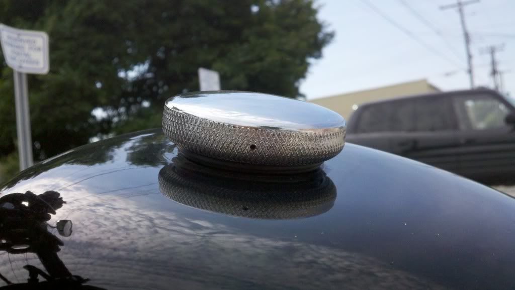

I had a problem with bike not pulling too good so I loosed up the gas cap and she pulls a lot better, thanks for the tip Gardo! I need to drill out the cap or get a new one. Here's a few pics:

JK3 a 5/64 drill bit will do the trick I have the photo just need to up load it. did it for my buddy Matt and his bike was riding great on Monday

Thanks guys, yeah Gardo that pic would be great. Still not sure where to drill this thing. I'm assuming one hole in the bottom but the other one I'm not sure about.
I got a vented cap from ccw. And they had the hole drilled on bottom and for the top they drilled into the textured part around the side where you grip to take the cap off

JK3 I have another cap i just drilled out, if you want to swap yours for this one. Cant find the Pic think my berry ate it will take another tonight of the cap.
MK2 thanks for the pic upload

Gardo thanks for the offer, I'll just drill my cap when I get home. So the pic that MK2 posted is what I have to do?
