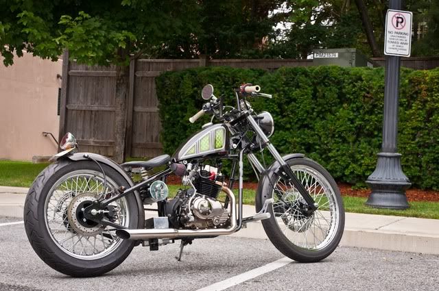

EVERYONE post up some pics! Just wanna see what you guys are doing with these bikes!
http://i1090.photobucket.com/albums/...t/_DSC9573.jpg
Can't have too much Widow bro. Post up. I was actually just thinking how good this NGK wire would look on your bike. Fits the red theme and all.
http://i1090.photobucket.com/albums/...t/_DSC9568.jpg
It's pretty much the same as last week when I got it but I found some coke bottle grips and just stuck 'em on tonight. If my exhaust wrap shows up in time I hope to wrap it this weekend. I'm looking for a particular decal to dress up the tank, but so far I can only find it online in the UK. I've got plans for a kickstart lever that involve welding (which I don't know anything about so I'll have farm that part out). Unfortunately I don't know what kind of metal any of the known levers are made of and whether or not they're suitable to be cut and welded.
