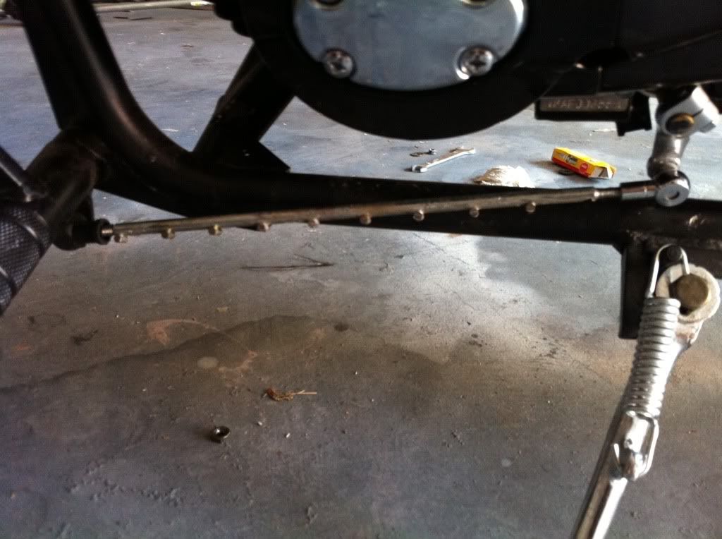

Please post photos of your shift linkage improvement?

Looks like the linkage could be made from a piece of "Redi-Rod" and a couple of clevis ends. All available from a NAPA auto parts store.

I am still running the stock shift linkage with no problem.

Evokid8, how did you get the reverse threads on the one end your wire rack shift linkage?

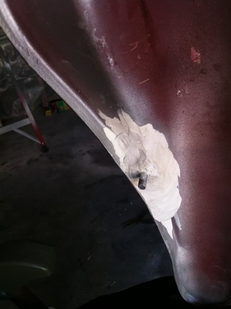

about the tank, yes it was VERY thin! when the new one comes im going to add welds to seal it better. and the shift linkage, you tap it normally on both sides. when you insert it, the foot/front part of the shifter goes in righty tighty, the rear one goes on lefty tighty, INSIDE the rear part of the shift linkage is reversed. so when you put your own one on, line them both up and screw it in at THE SAME TIME and it'll go in perfectly. hope this helps!
Re: Dong Fang DF 250 RTB Bobber Information
I took My gas tank off to check out the wires and noticed one of the spot welds on the threaded brackets,had broken loose.(I haven't even started the motorcycle yet!):eekers:
My intent was to apply JB weld anyhow, hoping to prevent any possible leaks. I haven't put any fuel in it yet.
