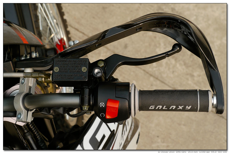

OK I can not find a good translator for that page. I want those pictured with the extended shields. Can someone direct me to a translator?

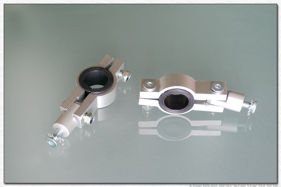

Milton: The aluminium clamp on the handlebar is the wrong one for your kind of handlebar, these are a better fit and use a plastic bushing which helps with vibration.
http://www.contactdi.com/2010/gear/1000800.jpg

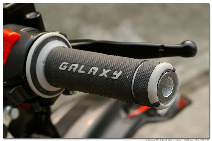

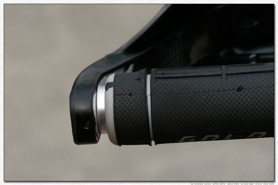

Everything should fit together tight and not have a large gap at the end of the bar where it meets the grip.
http://www.contactdi.com/2010/gear/1080485.jpg
Euphonius and I each bought a set. The clamps you showed did not fit my bike. It supposedly fits Euphonius' which is steel and not tapered like mine.

Cut your handgrips with a razor. The left one is pretty easy to do, the right one requires more precision, as you don't want to cause the throttle to bind.
http://www.contactdi.com/2010/gear/1080491.jpg

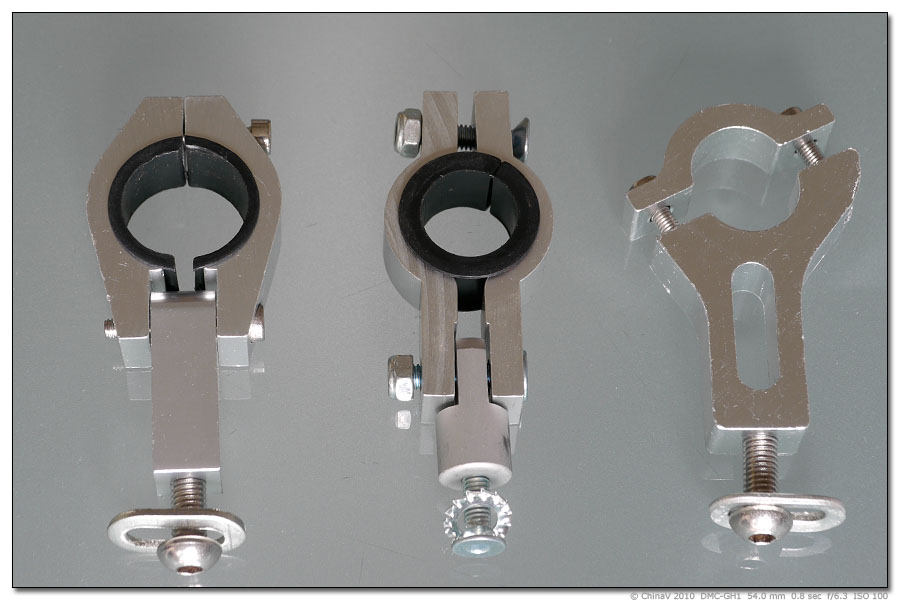

Now comes the part where you need to do some mixing and matching. These are the three different mounting kits you will find on almost all the hand guards in China. Depending on your bars, the middle one is usually the best. If your handlebars are too big, the plastic collars in the left hand ones can be used instead. The reason I like the middle and left hand ones, is that they pivot a bit which helps in the installation. I have never had to use force to install these on any bike. Just put them on and finger tighten everything without any issue.
http://www.contactdi.com/2010/gear/1080506.jpg

Be sure to leave a little gap on the left and right hand sides of your throttle grip. If you are replacing your grips, a little spray paint on the inside works great to keep them from slipping.
