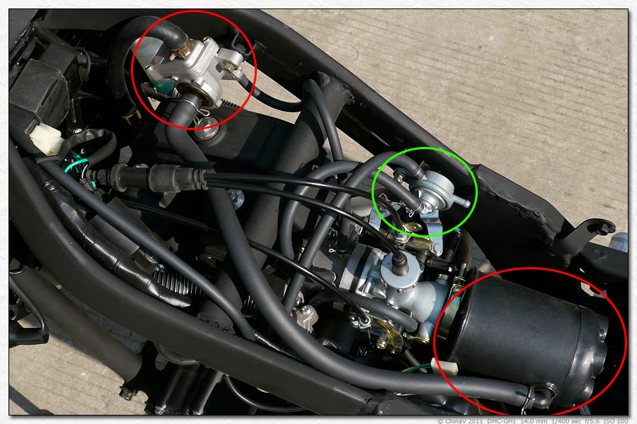

Decided to dig in and get rid of the smog pump (S.A.I. secondary air injection). Not really a performance mod, as all it does is inject air into the exhaust to burn off excess gasses, but it was part of the mess of hoses and holes in the shroud covering the air filter. The SAI valve unit is circled in red in the upper left hand corner, the vacuum operated fuel petcock is circled in green in the center, and the air intake shroud is circled in red in the lower right hand corner. Quite a mess of hoses, and the air box shroud is total shit.

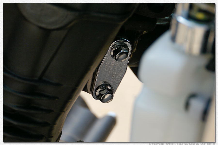

On the front of the engine, next to the exhaust pipe, you will find the intake point for the SAI.
http://www.contactdi.com/Processed/1080874.jpg
Fortunately I already have a block off plate, gasket and screws.

Don't forget to block off the suction point once you've removed the SAI. You can trim a small piece of fuel line and put a screw in it.

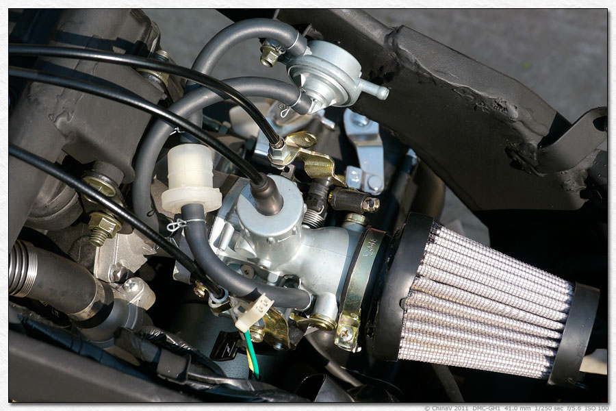

Bike is running better without the shroud surrounding the pod air filter. I see no need for jetting changes, maybe a couple percent improvement in power. I'm not a competent engine tuner, I would like opinions on replacing the pod filter with a smaller or larger K&N unit. Bottom end is where the bike suffers the most, but it's getting better :thumbsup:.
