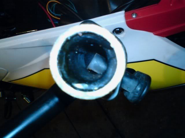

Actually, got a question here: when warm white smoke comes from the exhaust. Could it be that that HF thing doesn't route exhaust gas properly? Something else? The bike's in the break-in period and I haven't gunned it at all. Do I have any reason to worry here?

White, you said? Is the air in Nanjing humid? It is probably steam - water condensed inside muffler evaporates.
I saw that HF thing have some rubber hoses. Therefore I doubt that this thing is doing something with the hot exhaust gases.
Are you checked so far what is the color of soot on the spark plug electrodes, that is, whether is the carburetor adjusted?
Do you have any reason to worry? Till you do not get familiar with every bolt on the bike and how each assembly work, you have reason to be worried.

Its called an (SAI) secondary air intake, it’s a reed valve that operates on vacuum/pressure from the carburetor. When it opens it let air into the exhaust side of the manifold, oxygenates the exhaust to ensure unspent hydrocarbons are fully spent.
Some take it off because they think its ugly, others take it off because they believe it raise the temperature of the engine….I swear I can hear it, its double reed valve, I swear it makes clicking noise that comes and goes with accelerating and decelerating.

The air's humid as hell, in summer it's like living in a fishbowl. Took the spark plug out - no soot/not black/not shot. The bike's got like 100 something km on it, all ok.
That's right with the rubber lines - got no idea why/how that is related to exhaust gas...

My smog pump was installed on the the exhaust and had no contact with manifold.
http://i931.photobucket.com/albums/a...atalizator.jpg
I replaced the entire exhaust pipe, because the entire assembly of smog pump, along with the catalyst, reduced the flow of exhaust gases.
