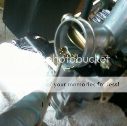

Well at least we now know, its apparently a 45 slow and 105 main jet that attains that "track" like performance...
On a similar note, i adjusted the throttle cable to the pump from min to max, and in fact found it gave me approximately 4mph more indicated on the top end...
thats 62 slightly down hill... and i believe it might have helped with the top end spudder as well.
i wont be sure until i give it a few more passes, just to be sure it wasn't a tail wind or something.
Im going to do the dan reverse tube air ram next...
Keep those jet reports coming, that will be the next step... so far it seems 108 is optimal with stock air filter, and 112 with reversed tube ram...
