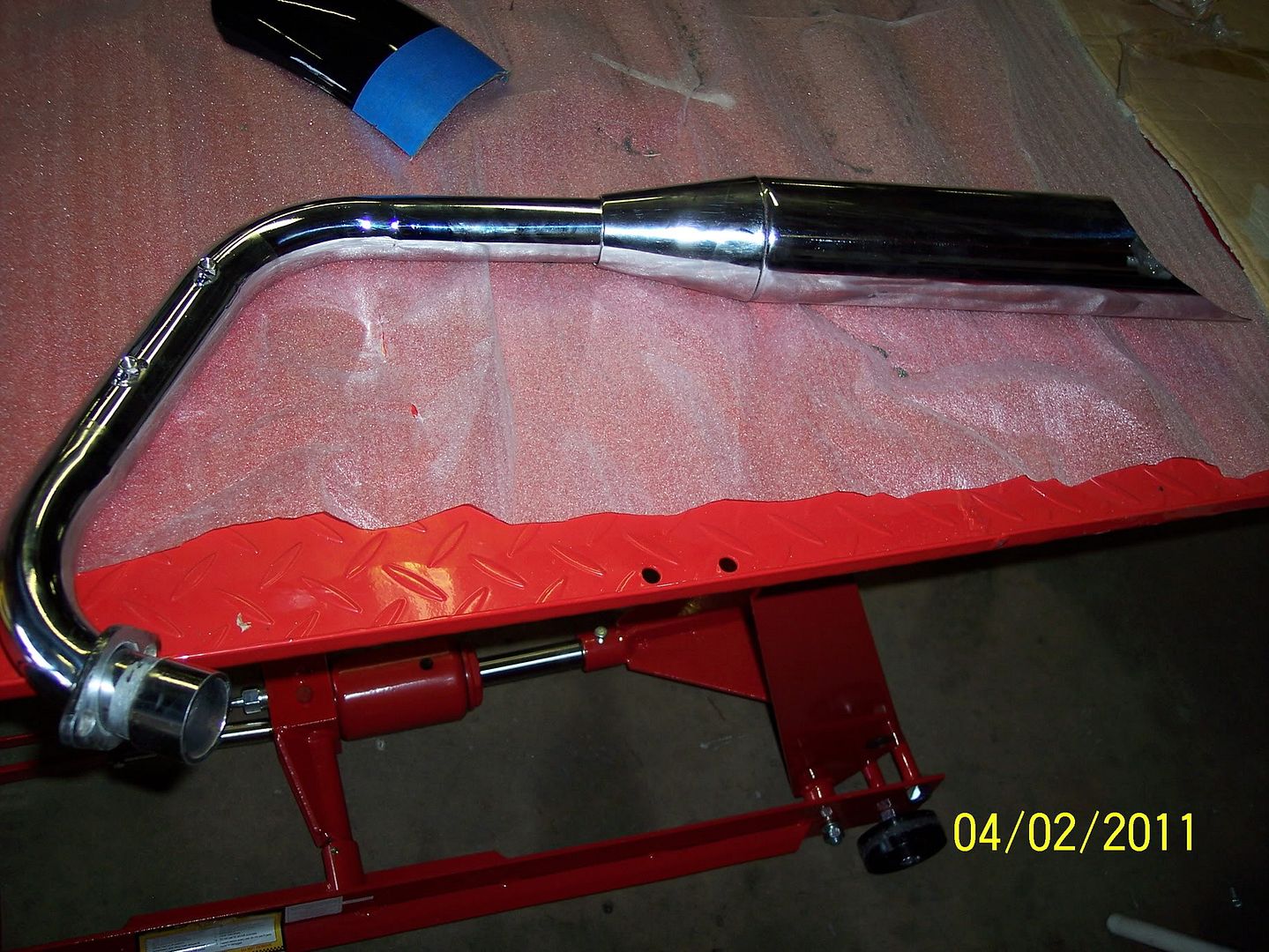

I've got some other plans for the bike, but I had a question about exhausts. Is there anything preventing me from just lopping off the exhaust where the pipe starts to flare for the muffler? I really want to get the kick start working, but at the moment I can't afford to get a new set of pipes that will clear it. Anyone have any suggestions?

NBowen, good to see that you have the bike i like the turn signals, the new mirrors remind me of the tha Misfit mirrors. I usually scour ebay for parts since most metric parts will fit the Heist. I founds tons of stuff on the cheap.
As for the stock muffler there is a cat right at the part were the exhaust flairs. for a nice sound I would chop the last 6" off the back of the pipe just like this
http://i122.photobucket.com/albums/o...t/100_3997.jpg

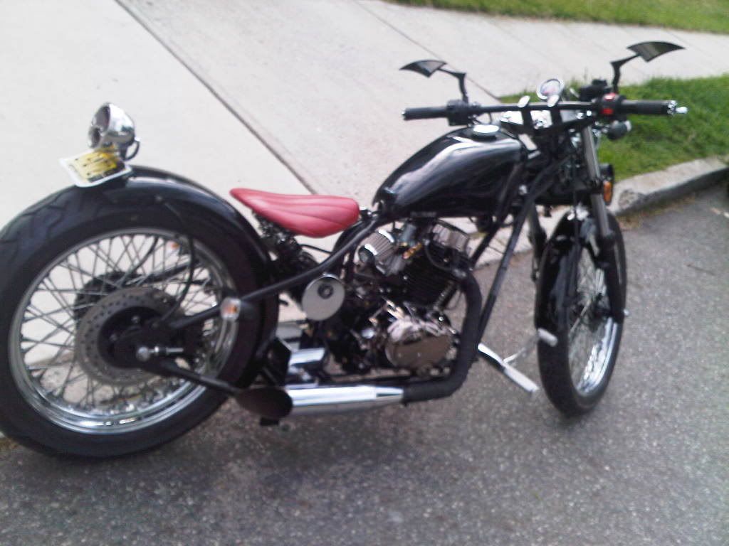

Will need to rejet the carb once thats done. I swapped out all my lights and did some upgrades
Here she was in June
http://i122.photobucket.com/albums/o...508-1646-1.jpg
