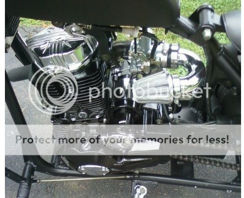

Combination of cat removal and ram air yields no noticeable improvements
http://i924.photobucket.com/albums/a...ps2d2c0fed.jpg
