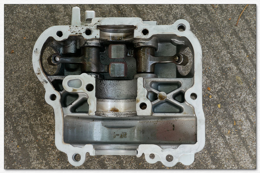

Rolling along one sunny afternoon I started to hear a bit of tapping from the engine. I headed back home to the garage, let the bike cool down, and did a quick check of the valves to see what might be up. Intake was fine, but the exhaust was way out. I put it back in spec and within a few minutes it was tapping again :confused1: . I decided to pull the cam cover off and inspect the top end.
http://www.contactdi.com/2009/qm/QM0067.jpg
It didn't look good. For some reason, the top end was starved for oil and most of the parts were pretty cooked.:eekers:
http://www.contactdi.com/2009/qm/QM0068.jpg

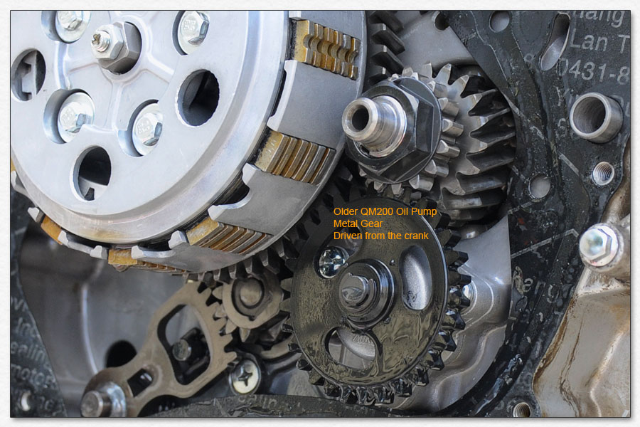

The first thing I did was look back through my old photos of the QM200 as I remembered the oil pump was driven with a metal gear directly off the crank.
http://www.contactdi.com/2009/qm/QM0073.jpg

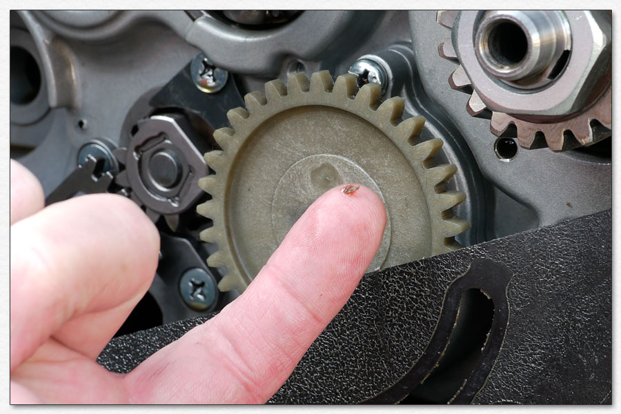

The new system of the QM250 uses the same Mikuni oil pump as the QM200, but it's driven from the back of the clutch. The gear is made of a very lightweight "plastic" material. It looks like a PA66 resin, but it could also be Stanyl. Manufacturers use this type of gear to reduce weight, cost and noise. Under most circumstances I think the gears would be fine, but I remember the 87-99 Kawasaki Vulcan 1500 had some issues with the same type of gear. Mine looked OK, but I then noticed some small plastic shavings in the oil.

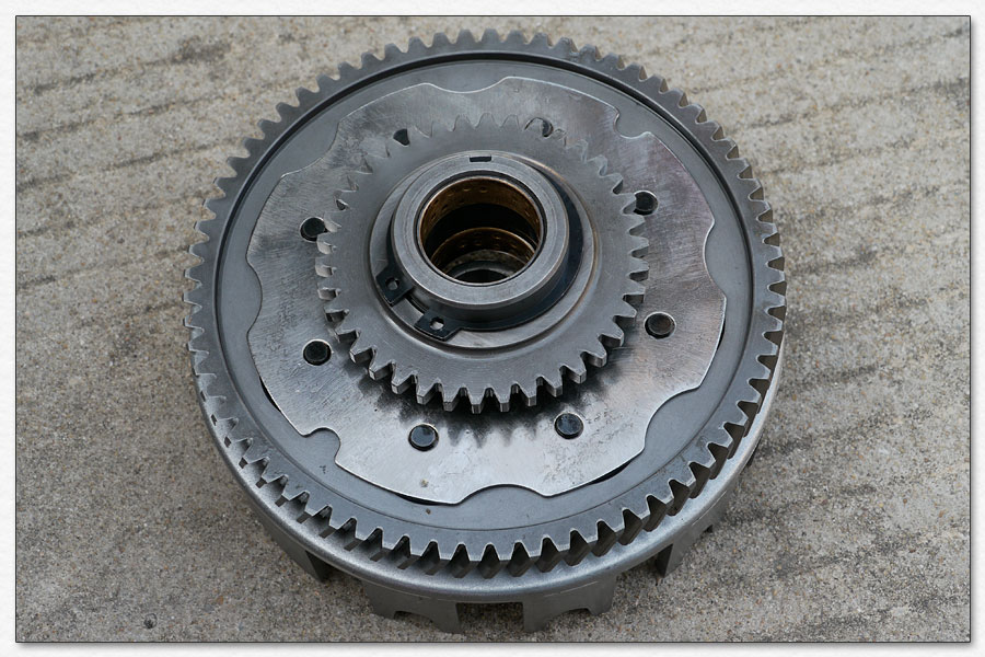

On the back of the clutch, the gear in the middle was not making good contact with the plastic gear.
http://www.contactdi.com/2009/qm/QM0071.jpg
Over time, the plastic was slowly shaved off and eventually the gear was barely making contact. I tried to rotate it with my finger, sometimes they would catch and sometimes it would slip. Here you can see the damage inflicted on the plastic.
http://www.contactdi.com/2009/qm/QM0072.jpg

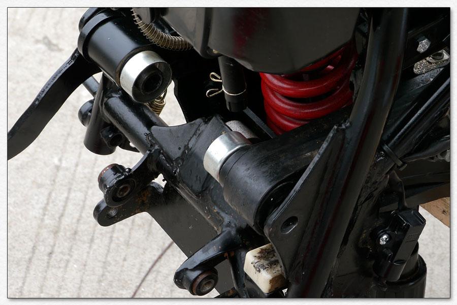

The difficult part is getting the frame and swing arm pivot to line up here.
http://www.contactdi.com/2009/qm/QM0078.jpg
An extra set of hands would make it pretty easy, but I managed to finally get it in using the lift and my car jack to raise the rear swing arm. A little swearing helped as well. :icon10:

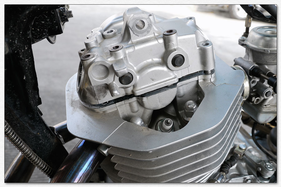

Excellent write up and pictures as usual V! I'm glad that you had such a good response from Qingqi on your problem. Just a question. Did you have to take any precautions when you took the top of the head off? I think it was posted in another thread that there might be things underneath that might fall out. The reason I ask is I have the Qlink XF200 and would rather take the top off to check the valves if possible because of the tight clearances between the frame and the head.

That's a good question david, it's a bit of a pain doing it though the inspection caps, unfortunately you have to leave the top on. When you pull the cover, the rockers come with it and the gap can't be checked.

Thanks for the quick response. I checked them last summer through the caps with some feeler gauges that I bent at the tip. It worked but was clumbersome. I suppose I could pull the motor if I was overtly concerned. It is running well so I guess I did it right. Thanks again.
