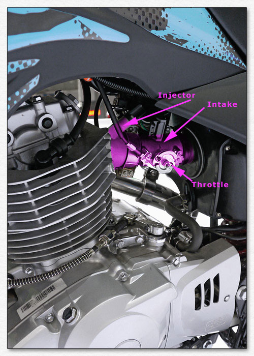

So a fuel injector will look something like this, except on the bike you will see some specifically electrical wires leading away and a few hoses.http://www.mbe-motorsports.com/catal...r_DH020M_6.jpg
A carb looks like this:
http://www.patternparts.net/images/ww/parts/221899.jpg
So the difference is: If you move the throttle grip, a throttle body on the carb will move if you have a carb. If you have FI then when you move the throttle grip nothing will move visibly. Also a fuel injector has electrical wires.
Also FI is so rare on Chinese motorcycles it will probably be written down the side of the bike!

I think the photos ZMC posted should make it pretty clear. You will notice that a FI unit looks like a straight tube going into the motor and a carb has a big resevoir on the bottom that holds gas. If you don't understand those, feel free to send pics of the bike you are going to buy and we will verify the FI for you. Again, the pics you posted before are not FI as you can clearly see the carb.
Here are some more pics showing FI vs Carburetor
http://www.contactdi.com/2010/fi01.jpg
http://www.contactdi.com/2010/fi02.jpg
Fuel Injected:
http://www.tesztmotor.hu/images/stor...25_2010_03.jpg
Carburated:
http://motomaya.com/turismo_files/20...25ESD_AZUL.jpg
Re: Regal Raptor DD250G-2
That's perfect! Thanks a lot guys.
