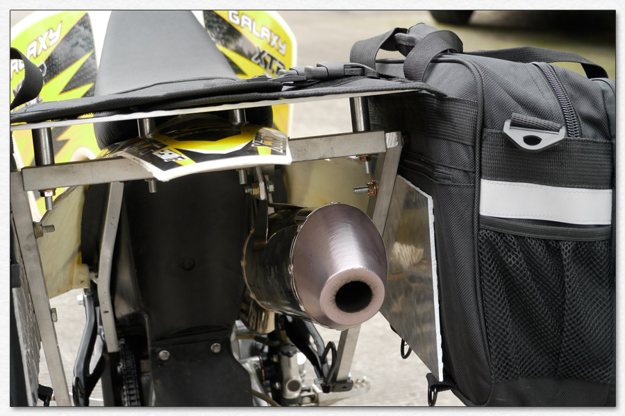

In the mean time, I finished up my mounting system for the bags and rack. Let's go back and re-cap what I did to make this work. Here is the original rear subframe of the bike.
http://www.contactdi.com/2009/galaxy/XTR052.jpg
Removed the rear section.
http://www.contactdi.com/2009/galaxy/XTR048.jpg
Added my new support bracket.
http://www.contactdi.com/2009/galaxy/XTR049.jpg
New License plate and rear light brackets
http://www.contactdi.com/2009/galaxy/XTR050.jpg
Supports go to the passenger pegs to relieve weight on the top of the rear sub-frame.
http://www.contactdi.com/2009/galaxy/XTR051.jpg
Added side plates to keep the soft luggage from making contact with the wheel or exhaust pipe. My bike doesn't have the side plates as I'm using the hard cases.
http://www.contactdi.com/2009/galaxy/XTR053.jpg

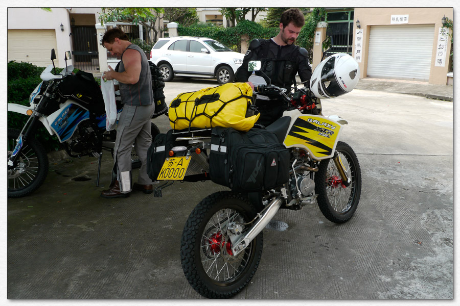

Felix's bike ready for loading.
http://www.contactdi.com/2009/galaxy/XTR047.jpg
And fully loaded.
http://www.contactdi.com/2009/galaxy/XTR054.jpg

Great fab work V! I noticed the air clear in some of the pics. Do you have to remove all of the screws to change it out?
PS-Is it just me or does Felix look like Charlie from 'Lost'?

Primo job on that rack V. Mounting it to the foot peg was definitely the "Right thing to do" (tm).

I think Felix is a bit closer to "The Night Rider" from the 1979 version of MadMax :lol8:
