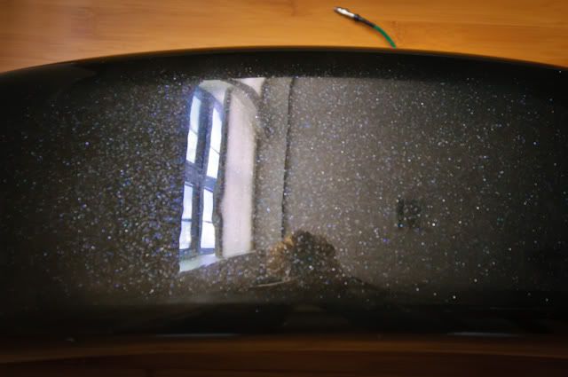

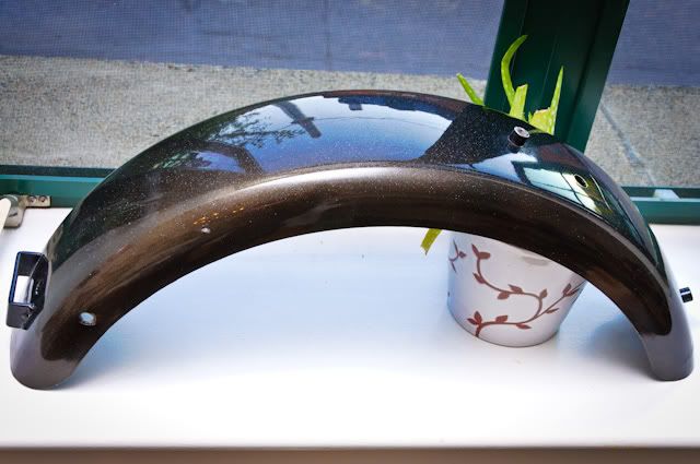

I actually just painted my fender a few weeks ago. Wanted it to match the dark color of the gas tank.
http://i1090.photobucket.com/albums/...t/_DSC9374.jpg
http://i1090.photobucket.com/albums/...t/_DSC9556.jpg

If you've never painted before do some internet research. It's easy if you have done some painting before, and have some basic knowledge. I sprayed Autoair paints through an airbrush. On the tank I used Spraymax 2K Clear, a 2-part clear in a can. It's gas resistant. You can also use it over some rattlecan color.
Read up on prepping parts for paint. The prep is the key.
You can paint your tins in one day start to finish. I spent about 6-8 hours on the tank. Can't remember, but I started sanding mid-morning and by dinner the clear was done. If I'd done the fender as well it wouldn't have added much time to the total. It goes quick if you work assembly line style. While one is drying spray the next etc.
The water based Autoair colors really require no drying time. Spray light coats and hit with a heat gun. You can actually see the water evaporate right out. I did 3 light coats and 2 slightly heavier of each Autoair color. Heat gunning between coats.
