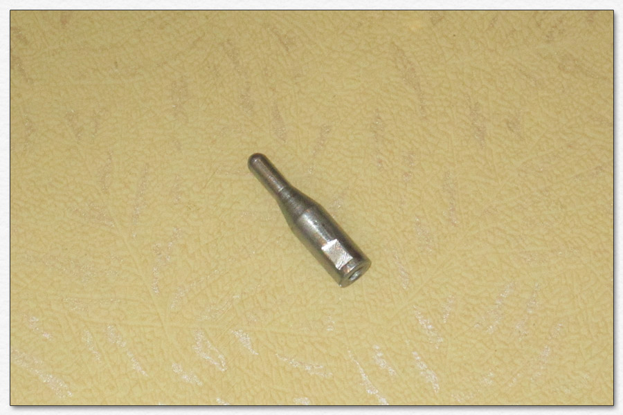

Galaxy came back to me regarding the faulty throttle/switchgear assembly and missing brake master cylinder push rod.
Firstly Galaxy said that it's not a problem that the throttle/switchgear assy rotates :eekers:. I have to disagree there......it's bloody dangerous !! There is no clamping force at all on to the handlebars....the whole assembly can be pulled completely off the handlebar with no effort. The only thing holding it in place is the throttle cable and electric cables.......so no joy there with a replacement part, I'll have to fix or bodge it so it clamps on.
Secondly the master cylinder push rod...Galaxy said it would be too expensive to send out and suggested I source one in the UK. The thing wheighs only a few grams and would fit in a the smallest available jiffy envelope. :rolleyes1: So no joy there either. I'm trying to find if any SMC dealers have any left in stock, or if one off another bike will fit.
God knows what I'm going to do, when I need any more important/large parts in the future :rolleyes1: I think my XTR will eventually turn into a Mongrel hybrid...........or a White Elephant :lol8:

Re: Galaxy XTR 250 Review
If this is what you need, I can drop it in the mail.
Yes that's the bit I need, but I also need the spherical bearing bit that attaches to it, and bolts onto the brake pedal. Don't suppose you have that bit aswell do you ?
By the way, did you see my post about the handlebar risers on your XTR thread ? Give me a shout if you need me to get some for you.
Cheers
Andy
