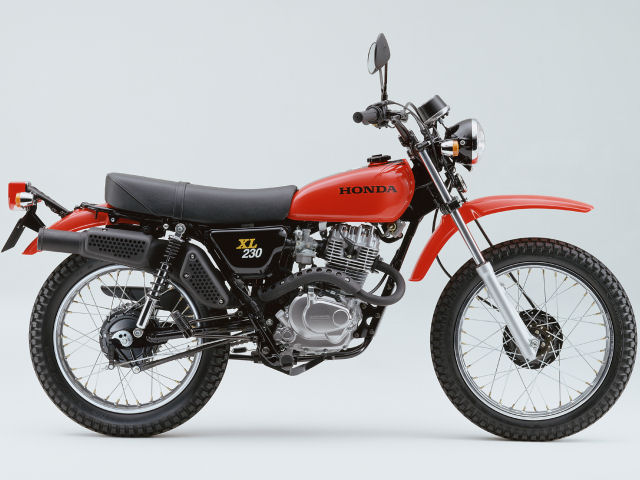

This group called Super Motor has been working on this for some time.
It looks to be based on an Xl230 frame.
http://1.bp.blogspot.com/-GB15qB9wkA...0/HONDA_XL.jpg
The guy working on it is named Dimitri Hettinga
They are using YinXiang as their OEM.
Dimitri has also contributed to Mega China Motor World.
