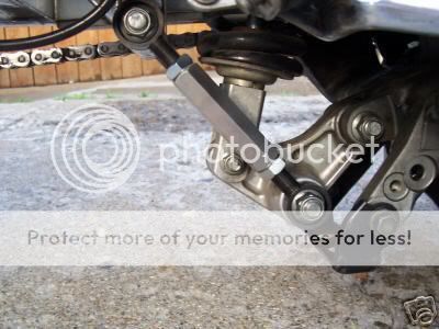

My two cents: I think that good solution can be custom made (because those are probably cheaper), adjustable links (no matter are they simple one, with 3 or 5 holes or those with turnbuckles), so called - "dog bones".
Using those, you can adjust seat height and keep standard geometry of the bike regardless of the monoshock length or when the bike is loaded like a mule.

To stiffen suspension - no. That is basically job for the spring preload system (no matter is the one with the 4 or 5 levels or the one with thread).
I mentioned those adjustable length "dog bones" because you are considering purchasing non-stock (longer, stiffer, heavy-duty... you name it) monoshocks. In order to fit longer shocks, and at the same time, to keep the same seat height/bike geometry, you'll need something like those new, different than stocks "dog bones".
Yes, fancy, nicely shaped, powder coated "dog bones" are not cheap, but I already mentioned that. It is not a rocket science to take two strips of hard/thick enough sheet metal and after some measuring, to drill three holes in a row and get something like this:

Or, something even "more adjustable" - "dog bones" with turnbuckles:
http://i768.photobucket.com/albums/x...nk_on_bike.jpg
All those things you can be fabricated in every machine shop for peanuts.

By "stiffen" I didnt really mean physically make it stiffer, just the feel as it changes the geometry of the bike a bit. It says that shorter dog bones will make your ride harsher which is caused by different position (angle) of the shock. It works as a lever I think, the shorter the harder is , in this case, to compress the shock.
I wouldnt be concerned about screwing up the geometry of the bike. Its small, slow bike and it doesnt matter as much as on those super bikes. Anyway, that guy, who I mentioned before, replaced his shock and the bike became so tall that he removed his center stand as it couldnt reach the ground hahah He said the bike felt good
I might make some cheap and see how the bike feel, if i like it ill get the real ones
