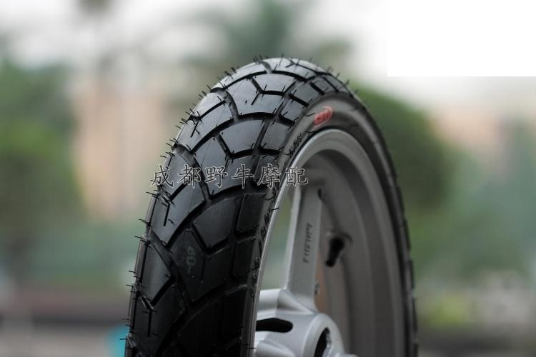

A wise investment esp on the front. If you can find a set in the right sizes, even better! :thumbsup:
I used a set before on my China trip and they were good. Lasted forever
Id like to put these on but they are bit cheap, better go with reliable

Are YBRahim's stock tires tubeless or with inner tubes? I any case, take with you set of matching inner tubes. Also, patches, tools and even can of tire sealant wouldn't be a "dead weight".
