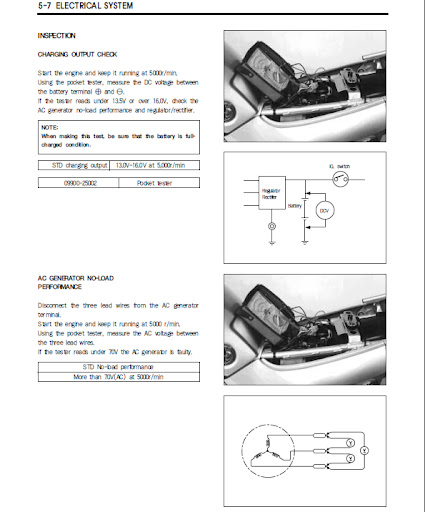

Did you try running the bike without the battery and putting a voltage meter on the positive and negative terminals? You should get a reading of something around 13-14 Volts, if it's 12 or under, you're not getting power. Could be the voltage regulator or could be the stator. You need to get a voltage meter and take some readings as electrical issues are a bit difficult to troubleshoot from your description.
To test the charging system you need a fully charged battery and a multimeter.
Usually the problem is the regulator / rectifier but it is good to test before replacing
The regulator rectifier suzuki motorcycle gn125 fits perfectly.
You can test the system by following these steps of the photo.
http://lh6.ggpht.com/_LJMljjfhaTs/TO...g%20system.jpg
