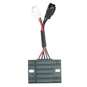

I have a pulse adreniline 125.
The old rectifier i have has 2 plugs.
1 plug has a red and black and white cable attached and the other plug has 3 black cables attached.
http://ecx.images-amazon.com/images/...mL._SY300_.jpg
The new rectifier i have has 1 plug which has
1 red, 1 white, 1 black, 1 green and 1 yellow wire going to the one plug..
http://thumbs2.ebaystatic.com/d/l225...l3kjOaW26g.jpg
The mechanic/parts sales man said to take the wires out the new plug and attach them to the old plugs i have but make sure i get the cables right.
DO YOU KNOW WHAT CABLES ARE WHAT? AS LONG AS I CAN ISOLATE THE 2 CABLES IN THE ONE PLUG , THE OTHER 3 SHOULD BE FINE.

the reason some manufacturer split the 5 wires is to isolate the output side -
the important thing is that the red and the black MUST go to the battery - the other three can be mixed up -it's not critical.
HTH

I already did it, and it connected perfectly.
The problem is the bike is still dying on me after about 30-40mins of riding....
Could it be the battery?
