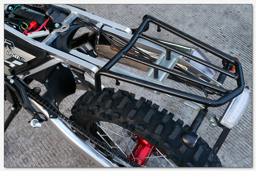

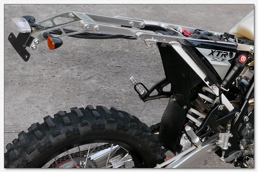

Nice to the see the racks on there with the extended tank. Couple of comments though...
1) Are they going to level out the rear rack?
It levels out a bit when the suspension compresses under load. As far as I know, the boys will be using soft luggage instead of hard cases.
2) How about widening the last 3/4 of the seat?
The seat is a little different than stock, but still pretty narrow for touring. I bought an extra and intend to make it wider, I have seen some nice DRZ400 seats that look good for touring.
3) The saddle bag standoffs may perform better if they are several inches forward.... 2 main reasons being better weight distribution/mass centralization and less danger of the exhaust pipe hitting any saddlebag material coming over the rack.
I don't think they will have any problems with the exhaust, but you're right about the position. Unfortunately the bike is so short in the seating area there is not much room to move things forward.
4) Does the alternator have enough output for auxiliary lighting?
Franki said they boosted the alternator, I'm going to try and get one today.
5) Much of the extended range fuel tank looks like it's below the carb/fi unit. Is there a fuel pump on the bike?
Yes, the bike uses a pump.

You're right about the mountain bike like frame. Now that I've seen the seat rail design, I'd seriously question it's true enduro capabilities.
My main concern would be in carrying the tremendous amounts of luggage we haul into the hinterlands on those 2 part aluminum seat rails. How thick it that metal?
With only four bolts holding that last tail section to the rail, I'm thinking after 20k kilometeres of bad roads and up to 100lbs of gear bouncing up and down on the top rack and side bags, these would eventually snap like toothpicks (or at least bend) and leave someone without a way to carry their luggage to a place for repair. Another wonderful alternative is the bolts could shear and would need to have new ones welded on since they're only single sided. For motocross or day-trip trail riding I'm sure it would be fine but long distance is long distance and the rules are different.
Maybe they could weld the rails together after the bolts are installed?
Just my .02...
Re: ChinaV's new Galaxy 250!
CC, you hit it right on the head.... way too much leverage for just a couple of bolts. Although the aluminum is nice, a steel subframe would be much better for making luggage mounts. Also much easier to repair with standard welding tools out in the wild. We'll see how it holds up on franki's bike :popcorn: I'm sure he'll give it a good thrashing.

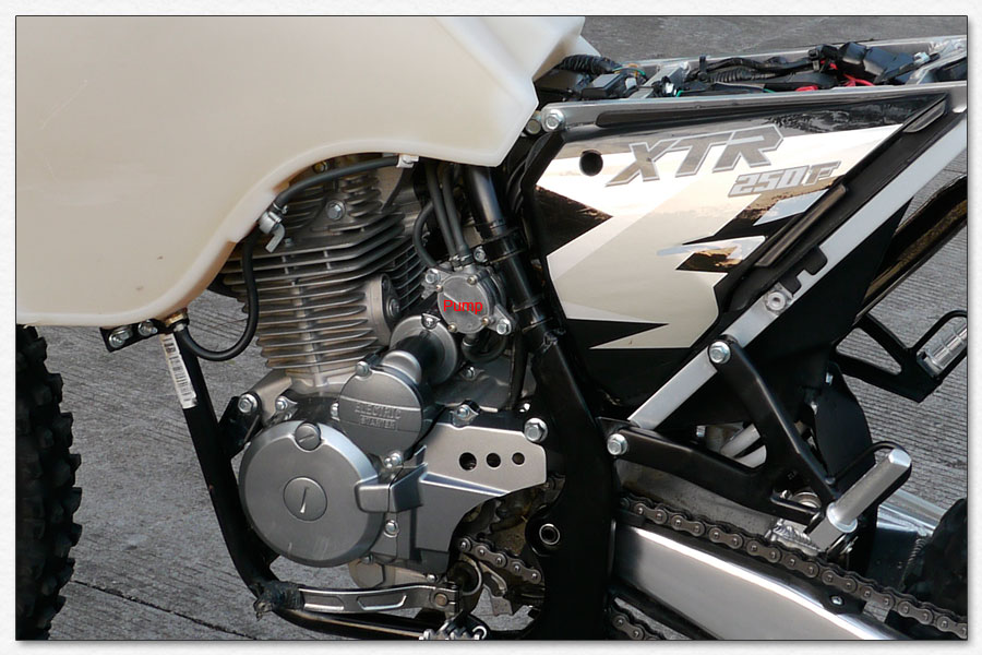

Next on the agenda was trying to sort out the sprocket and gearing issue. One of the things we all like about the QingQi QM200 is its clear connection to the Suzuki DR200. It's easy to find aftermarket parts when you're referencing almost any model from the big four Japanese companies. The lineage of the XTR is not quite so clear with it's 5 speed 223cc engine.
I'm guessing the motor is made by Loncin, and the design is based on a Honda. Exactly which Honda is a long story that started almost four decades ago when they introduced the 90cc Benly CB/SL series. Over the years, the same basic design was bored and stroked across the various CB ATC XL XR SL TLR FTR CRF families of 125/185/200/230cc motors. So far, I've found five models that are the likely "inspiration" behind the XTR powerplant. Based on designs from Honda Brazil, the FTR223, SL230, CB223, XL230 and CRF230 all share the 65.5×66.2 bore and stroke of the XTR, but depending on year and location, some are 6 speed and some are 5.
A little more digging and I found the SL230, FTR223 and XL230 share the same engine ID of MD33E, the CRF230 is ME09E. The FTR223 and XL230 have the same 5 speed gearbox so I believe these are the closest match to the XTR engine. If this is true, then the countershaft sprocket for the XTR should be the same as any Honda FTR223 or XL230. Why go through all that just to change a sprocket? We'll get in to that tomorrow when I share the results of some various gear ratios.
And for any of you agreeing with this or still reading along… I wonder if the 6 speed tranny from the other engines will work in an XTR? :naughty:

I'm still puzzled as to the origins of the engine. There are dozens of articles about the QingQi partnership with Suzuki and many mention it as a selling point. If these engines are based on Honda technology, why don't the factories promote or even mention it?
I have 17" motard wheels for my QingQi and the XTR. What do you think is the stickiest thing I can get that's produced locally? Don't really care about mileage as they would just be for fun.
Honda designs are either out of patent, stolen blueprints or leaked blueprints. Remember that Jialing had the first joint venture with Honda? Then they stopped making Honda badged bikes. But then lots of engines such has Honda 125cc singles and the 125cc twins and 233cc singles and 234cc twins started popping up all over China. Did Jialing sell off Honda blueprints? Or did Honda sell the blueprints themselves through Jialing? There are even 125 and 150cc twins in China. Nobody would bother to copy those engines unless they had blueprints for them.
