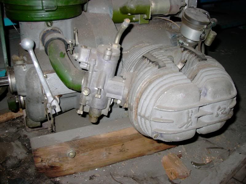

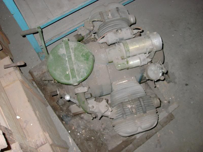

Then there was a very limited 900cc OHV........rare.......swingarm frame.
here's a couple pics of a NOS motor.
Then the "plastic" Chang..........not really plastic but it looks like it could be. Multiple manufactures, 12v flathead and OHV..........swingarm frame

That 900 looks like a beast. Too bad they only made a few.
