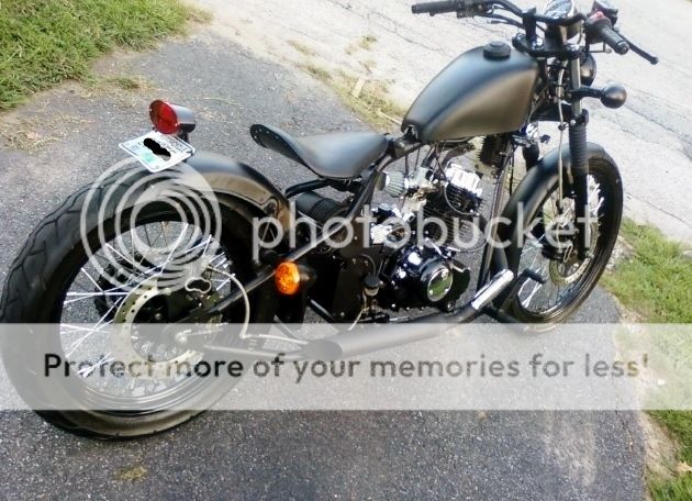

YES YOU AGREE!!!!! The 2012 does seem to run rich!!!! I swapped back to my stock jets, and my after market filter. The engine was breaking up with the stock filter.. I changed to my after market filter.. which actually has real filter material under the mesh, and a closed end. Man she runs like a freaking dream now.. I messed with the air/fuel mix.. and tossed in a new plug.. On flat ground I can cruise 55 no with no engine break up... still on hill i have to have her wide open to hold 45.. Im going to try on a nice straight flat road to try and do over 55.., maybe I can hit 60 now. I checked the new plug after riding about 10 miles.. and it looks exactly the same as when I put it in... so maybe I just need to put more miles to get a good reading.
I also cut off the tabs that held on the air injection... with nothing but a hacksaw blade in my bare hand.. and then a metal file. .. and a quick touch of with the satin paint I mixed previously for the tank and fenders. I know there is still a little stub of weld.. but after 45 min .. my hands were really tired.. so maybe I'll just use a dremel later and grind it down flat... but something about this bike makes me want to do everything by hand instead.. makes me feel like I really worked hard to do something.. lol
Oh that metal stuff behind the bike is a weight bench i was building (its not something hanging off the motor)2012 DF RTB_A
Satin black, 35 tooth rear

Hey guys. I know there were some new members to our DF posts asking questions about the bike. I just wanted to give an example of how the new 2012 looks with the basic modifications to make her ride better, and look pretty. I would invite you to compare to stock photo's to get an idea of how a few easy cosmetic changes can make this bike unique
2012 RTB_A
Current mods
1. Changed to a 35 tooth rear sprocket
2. Removed stripes and repainted the tank and fenders satin black.
3. Removed side mirrors (this is purely cosmetic and I would NOT recommend this because it effects safety)
4. Removed orange reflectors mounted to the sides of the forks (again this effects your safety and is just cosmetic)
5. Custom Rear fender to prevent the tire from rubbing (You can just shim the stock fender to prevent this issue)
6. Removed stock air filter and replaced with a better filtration cone and put mini filter on crank case hose.
7. Removed Air Injection unit and all components and removed mounting tabs.
8. Performance Plug slightly gaped over recommended specs for easy cold starts.
9. Replaced brake pads with genuine honda.
My next plans are to find some smoked lenses for the turn signals, and find some lower handle bar risers to make the bars sit lower.
Special thanks to everyone here for providing the information required to improve this bike, and special thanks to Barnone for going an extra mile to assist me with issues.Last edited by Bobthebobber; 08-13-2013 at 04:07 AM.
2012 DF RTB_A
