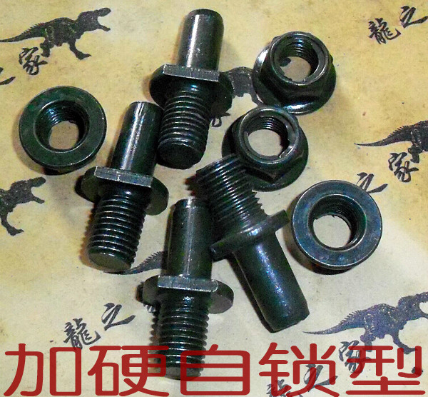

so what do you know about the sprocket studs? are not the genuine Honda parts gray rather than yellowed?
we're snapping them like crazy around here...

低處未見低,賤物鬥窮人 http://www.ebay.com/itm/111477736195
Parts house sold stronger [加 add 硬 hard 自 self 鎖 lock 型 type] version to mechanics

When i call a Honda dealer, they gave me this part number. so I am not sure if they are actual Honda or not, but the part number is. They seem to last a while. I mean I have 25,560 miles on the bike, and the studs in there have been on it for most of that after the factory ones broke. Yeah I replaced one a month ago, but they do not last forever.The bushings are like new as well. so I am happy.

Honda Part number 90128-382-670 is what I used in my DF.

alright so i assume they are holding up well and look a yellow alloy... my suspicions may well be wrong
I went ahead and bought a set of 90128-446-770, the old part number thinking this way i can ID the part is genuine or not...
I also often search the cross part number to get the best price possible... fwiw i got these studs shipped for 3.75$ each
i was tired of making and breaking studs, i suspect my 4140 pre hard (pre hardened rod) was not actually 4140 pre hard...Last edited by axa; 05-30-2017 at 02:57 AM.

I installed the Honda studs when I changed the sprocket back in 2012 or so and they are still in there.
