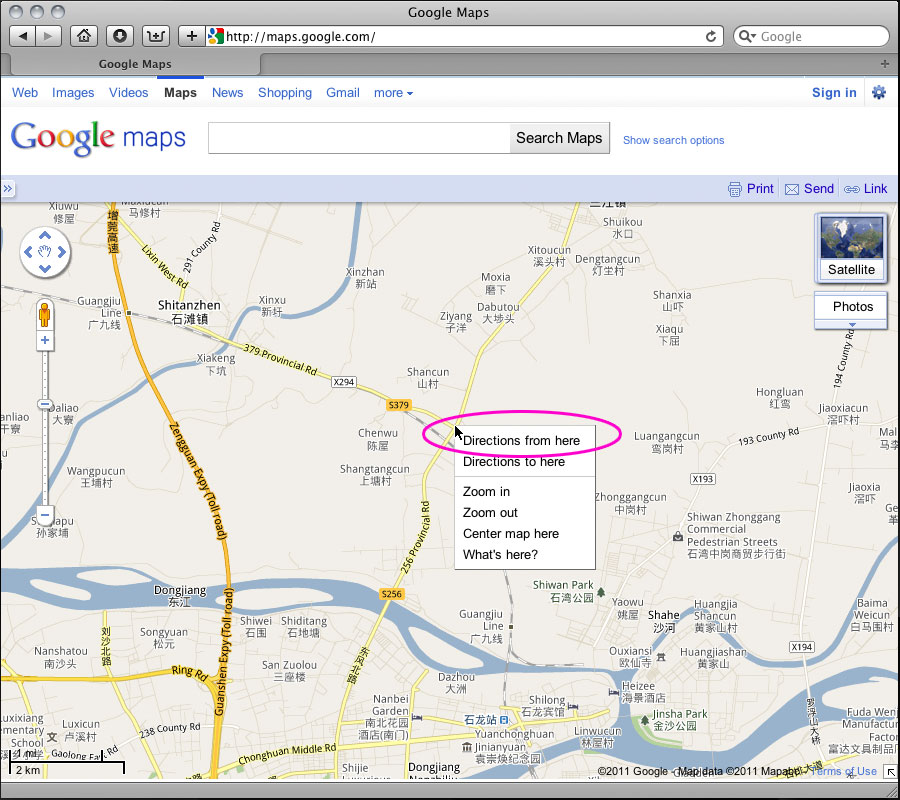

    #2 Figure out where you want to go and right mouse click on a start point. Select "Directions from here"
    #3 Navigate to where you want to end the trip for the day and right mouse click on an end point. Select "Directions to here".

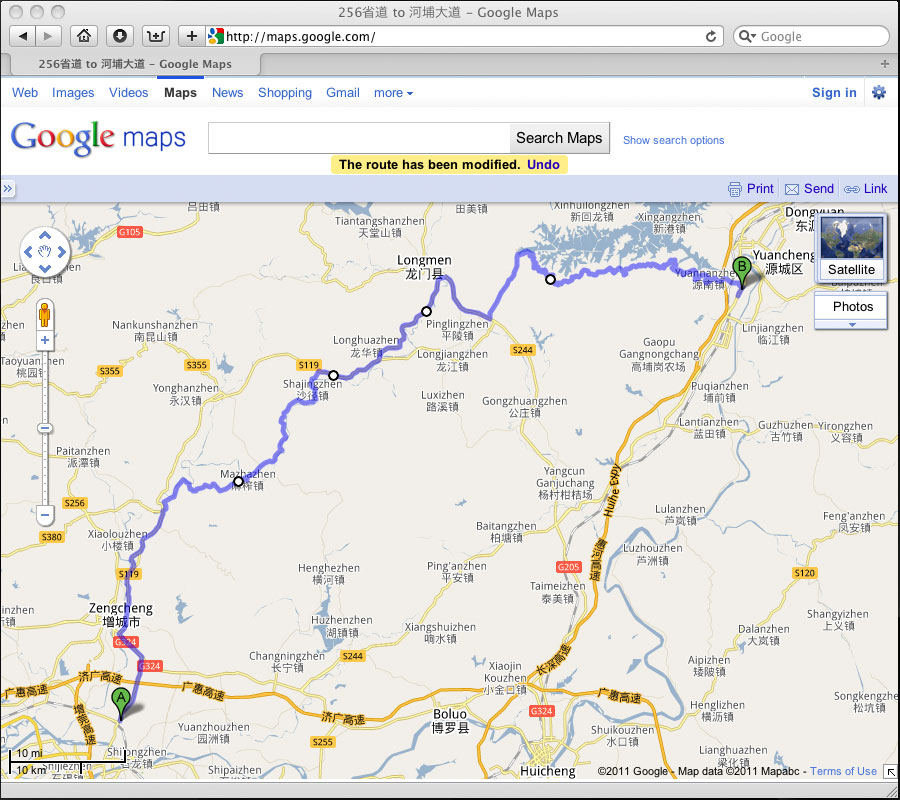

    #7 Use your mouse to "grab" your route by clicking on it and dragging the route to the road you actually want to take.
    #8 You can do this multiple times to create a complicated route adding lots of twisty roads. In this example, I made four custom points on the route. If you make a mistake, just right click on the little circle and select "Remove this point".

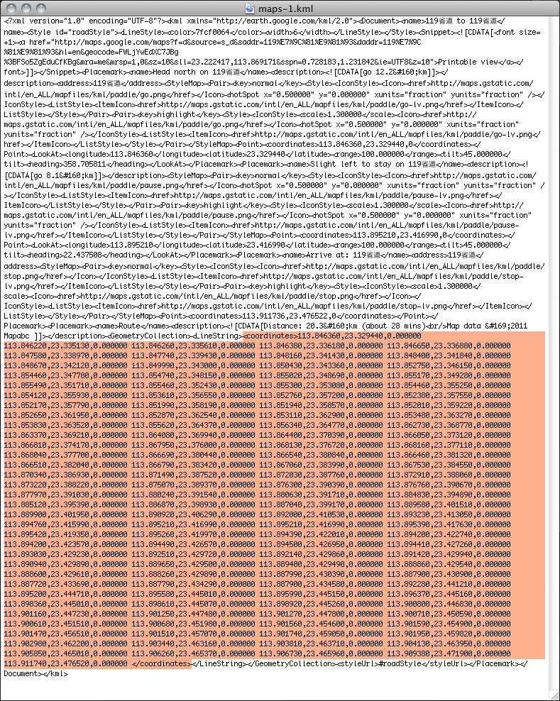

    #11 Let's open that "maps.kml" file in our text editor and have a peek. Lots of scary looking text. Don't worry, we're only going to use the coordinates, the part I have highlighted in orange. Go ahead and look for the <coordinates> statement and "Copy" it and everything else until you get to the </coordinates> statement. If you mapped a big route, you will have a lot of text to select. Just "Copy" all that info.
    #12 Now we need to make a new kml file with a header and footer that Google/Orux Maps will understand. Don't worry, I've already made one for you and you can download it here. This is the basic data needed to draw route lines on the map. You only have to worry about "Pasting" your data over the orange part I have highlighted.
    #13 After adding your coordinates to the the text file, you need to scan the file for "breaks" that google maps will sometimes insert on long routes. I recommend you remove these lines, as they sometimes cause problems and you will only see part of the route you created. Just scan the file and remove each occurrence you find, being sure you leave a space so it all looks uniform.
    #14 OK, the hard part is done, you can now save the file to your desktop, documents folder, or wherever makes you happy. Make sure you name the file "XXX.kml" and not "XXX.txt". You can put whatever you want for XXX, but I usually use something very short, like "107.kml", it's easier to remember short file names.
