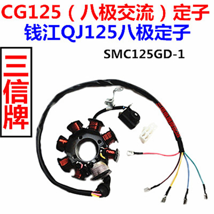

    Stator:
    https://youtu.be/q9-mr7BXIho
    [Energy] Source aka exciter... Bl/R >~50V | 300-600Ω Bypass it w/ "DC-CDI" is a streetwise fix
    [When] Pickup aka trigger... Bu/W >0.5V | 120-180Ω | the gap btw rotor
    [To r/r] Yellow /pink /white... Full wave NO continuity to gnd/ <2 ohm btw either wires
    Typical "8"
