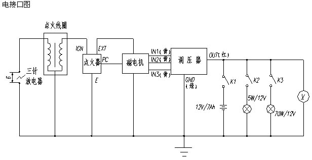

Jus bought a new CB250 engine, however the wiring is different.
The new engine has:
3 Pin Plug
-Yellow
-Yellow
-Yellow
Old engine has:
5pin plug
-Yellow
-Yellow
-Black
Anyway I can wire it into the loom?Lexmoto XTR-S 156FMI (156cc big bore) - 163FML Cams (+1mm lift) - Foam Filter - Sports Exhaust - 17T Sprocket - 110 Main Jet - PZ30 Carb - Aprillia RS Ignition Coil - Casoli CDI
My Project: http://xtrsproject.wordpress.com/
#2 Re: Wiring help07-15-2016, 10:57 PM
Just buy another 3 phase reg/rec & plug it in. DONE
