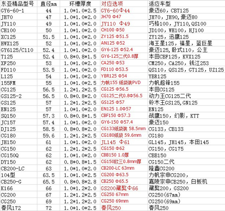

    2nd question.. which are the best rings for the 147cc big bore kit(62mm) ? i guess the 62mm CG150 ones, but i am not sure if the thick, thin ones or what (picture)

    [2] PVD type is the best BUT very difficult to find from retail... CID is better than regular... What u need is name brand 62: 1.2/1.2/2.5 (ie. the stone age CG150) rings unlike those T??? kit...

    2nd contacted the seller.. He didnt tell me if the "CG150 option Phi is 1.2 1.2 2.5 (or got any better link please which are for sure 1.2 1.2 2.5 thickness rings?

    Will order the CG150 rings.. the standard ones..
