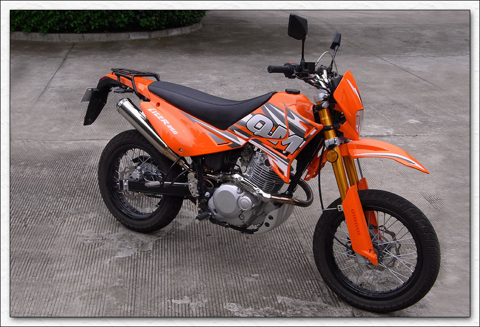

    I have a huge list of to-do's and modifications, so I will be dumping a lot of pics and random comments over the next few days. I've been hitting the bike markets for farkles, and QingQi for maintenance specs, so let's get started.
    If something is specific to the QM250, I will point it out, otherwise, most of this stuff is compatible with the QM200 family (motard/dual-sport).

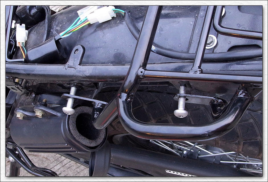

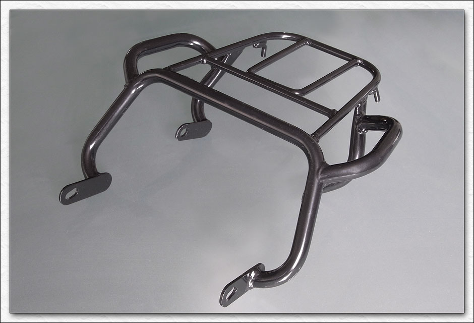

    The stock passenger hand rails look good, but are useless when you need to carry something. You can add the rear rack, OEM from QingQi.
    The rack should be simple to mount up, but both of the OEM units I purchased were less than perfect. I few extra washers and spacers and all was well, but I've seen better quality on other racks I purchased from QQ in the past. You can see that it's a little "tweaked".
    Pretty wide tolerance, I added spacers rather than stressing the welds on the rack.
    Installed and ready for (ab)use.

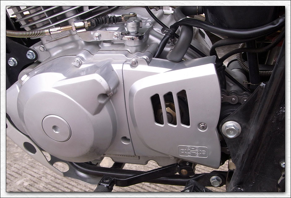

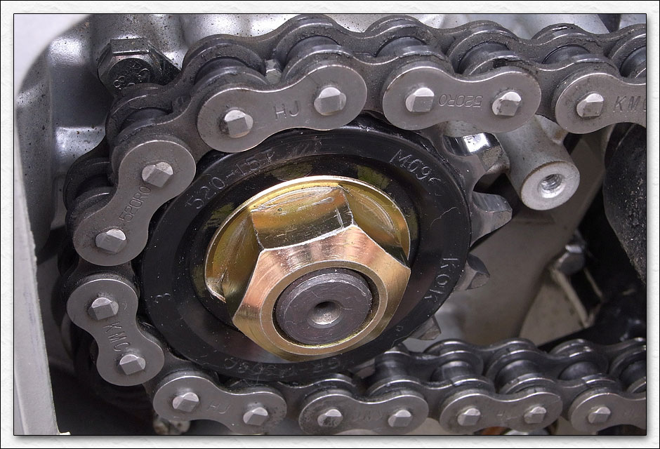

    I mentioned earlier that the rear sprocket is a 520/43T, I wanted to check the front and found it's a 520/15T. The outside cover is a bit different than the QM200, but it still has those annoying little 7mm bolts (should be 8mm like the other covers).
    OEM 520/15T Front Sprocket
    This is a very high quality rubber damped unit that is a rare find on most Chinese bikes.

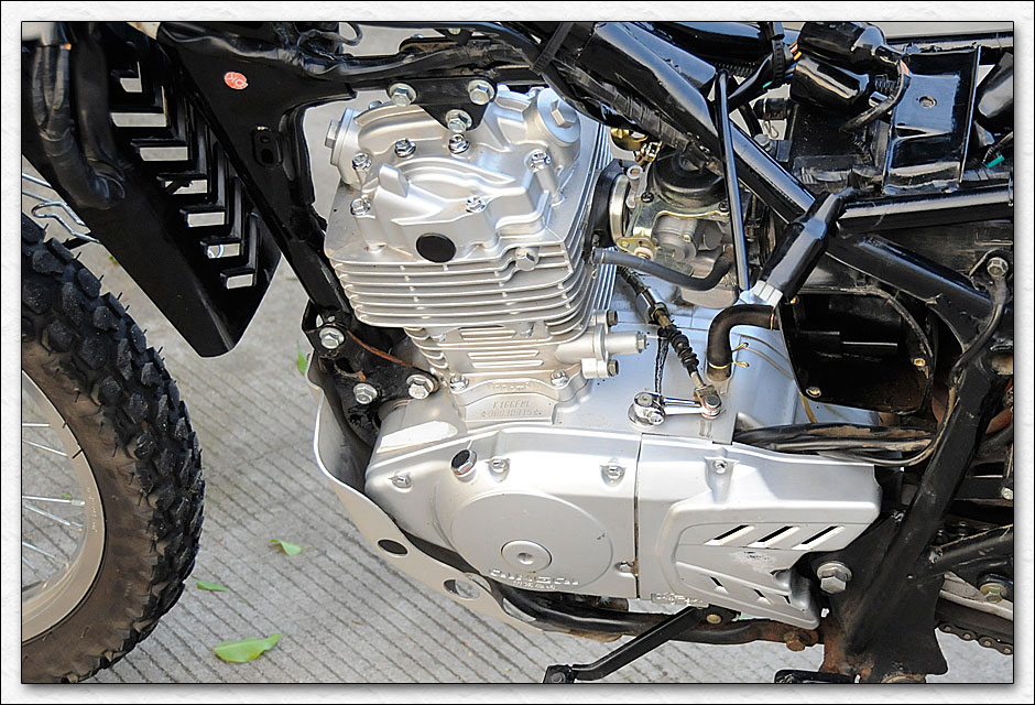

    Now that I've had a good chance to go through the bike from top to bottom, it's pretty clear most of the chassis and suspension is identical to other QM200 models. When I first saw pictures of the QM250, I thought they had simply bolted a larger head to the current QM200. Although it does look similar, closer inspection shows a very different motor.
    Here's a picture of the older QM200 engine. Left side has a cam chain tensioner and no spark plug.
    On the new QM250 engine, the cam chain and spark plug are now switched, but the stator and clutch remain in the same positions.

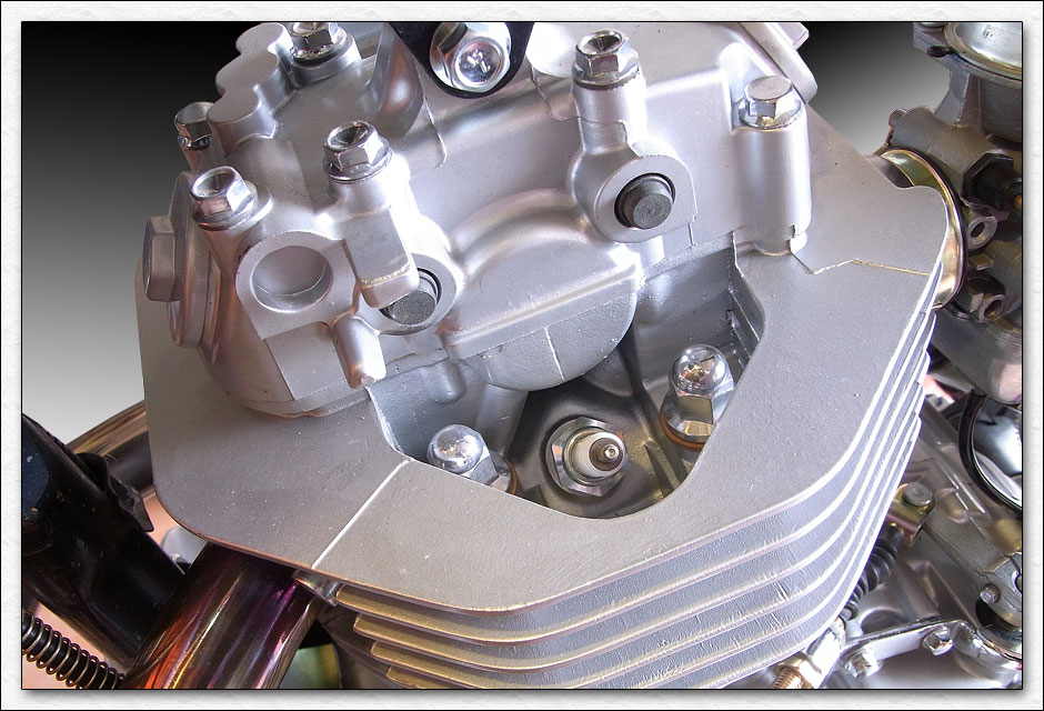

    The bike came standard with an NGK DR8EA spark plug. Mine was a bit white, which confirms my suspicion the bike runs a little lean, probably for emissions.
    Right hand side view.
    There is nothing radical here as far as engine design goes, it seems a bit uneventful compared to the liquid cooled models coming out of other Chinese manufacturers, but the simplicity of the QingQi may prove more appealing to some. Pretty much any mechanic throughout the world will feel right at home with the single cylinder, air cooled, carburated engine.
