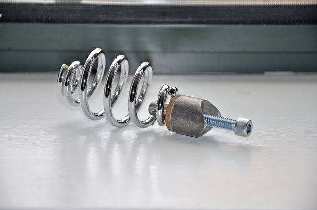

I also tried traditional 3" springs. There are already holes in the frame for them. Not much difference, They did have more side-to-side flex, and zero adjustability. Looked better than the shocks tho!
If you go this route DON'T bolt the spring directly to the frame. Use some kind of a perch. I used a weld on spring perch that I drilled and tapped for a bolt from the bottom side. There are bolt on perches available as well: http://www.fabkevin.com/Seat%20Sprin...g%20Bungs2.htm
In the end I got a West Eagle Seat and lightest weight choppershox. Huuuuge improvement. My bike is - dare I say - comfortable.

Here's the seat spring setup I tried. There are existing holes on the frame to mount up to.
I liked it! I had tried this with the original CCW seat. It dropped the back of the seat down pretty far though. Maybe I'll throw them back on with the new seat and see how it feels.
http://i1090.photobucket.com/albums/...seatspring.jpg

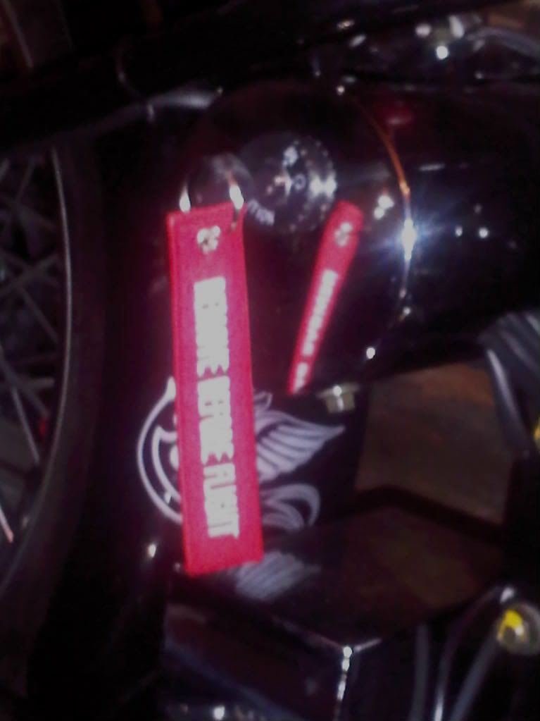

No vid of the keychain Gardo?!? :icon10: joking man joking. Your bike sounds so awesome on video.

Kev you are such a comodian, but no vid.... yet :lol8:
Yeah I'm gonna be heading to see tom in a couple weeks or hopefully have them come up for a bike night before hand. thinking of a few performance enhancements to the bike. Sprockets, carb, and such. nothing drastic oooo maybe a turbo kit, and a forced air ram and and .... :eek2:
Heres a pic of the key fob on the bike
http://i122.photobucket.com/albums/o...erx/keyfob.jpg
