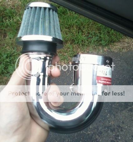

@ barnone.. I cured my cutting out problem after all the switching of the jets i did. Its running stock jets now with the closed ended filter and a little less than 2.5 turns out on the adjustment. No more cutting out.. I did mess with the accelerator pump though also.
Anyway i went to lowes today and picked up this stuff. I decided to spend a little more and get the joint-less coupler to keep it all chrome and not have the black rubber coupler. (im not using this filter with the ram.. it was just for the pic.. Ii will be running the stock filter until my new one arrives in the mail)
Im thinking I will mount it facing the left side so that it will not be taking in any exhaust heat
total cost on this was about 14 dollars

Bobthebobber
whats wrong with the setup you have in this pic above?
This is what i do with the stock filter, fixed my top end WOT issue and leaves me a bit of extra air without leaning it out according to the sparkplug.
But yet i still have enough airflow that i can apply a bit of choke with no apparent problems...
Does it give you too much air? The stock filter is apparently restrictive enough to prevent this...
By the way, you'll be able to butt that p-trap right up against the carb and minimize the size of the couple to about an inch, then the rubber black is at a minimum.
That said, the black on our matte bikes don't look so bad
check it out:
Attachment 13241
