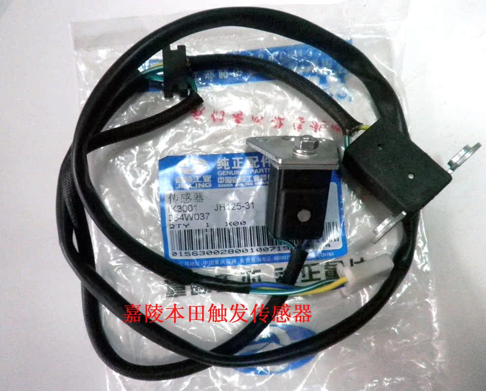

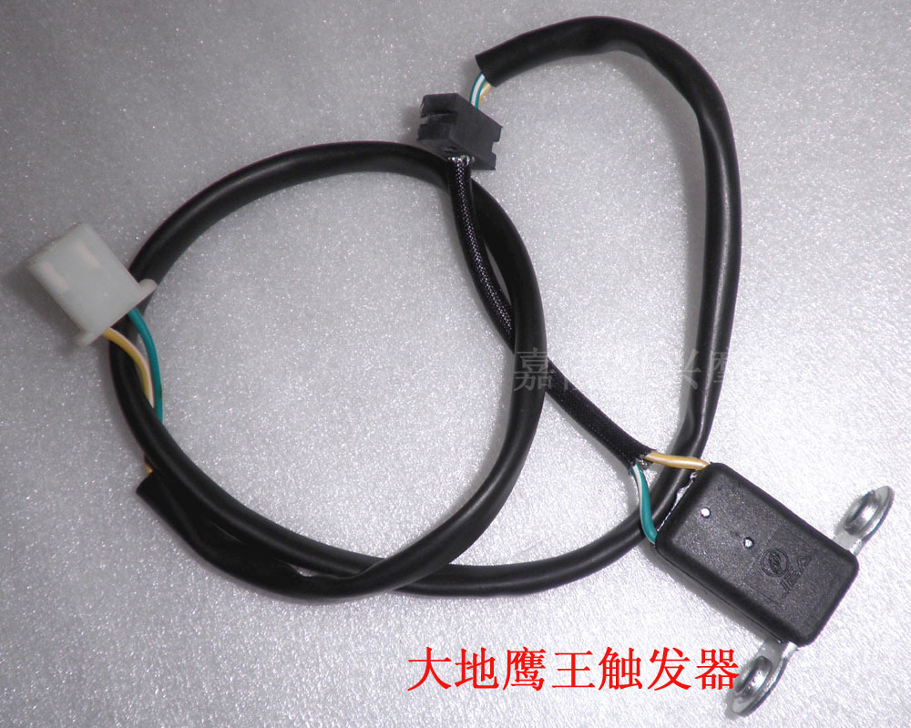

From the pluser, we can guess
180 crank -3 wire
http://gd3.alicdn.com/imgextra/i3/27...!270292713.jpg
Stock wire hardness obviously for 2 CDI
360 crank -2 wire
https://gd3.alicdn.com/bao/uploaded/...ZM5_054929.jpg
