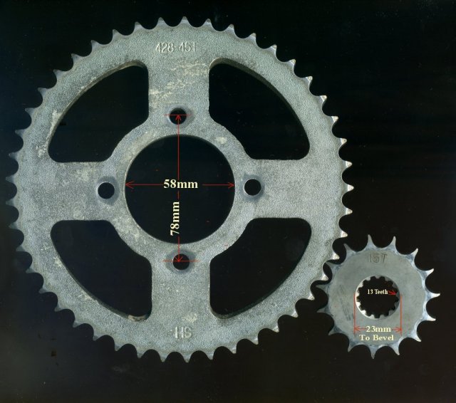

I am currently having difficulty locating a front (engine) sprocket for a Pioneer XF200-2V.
This bike is made by Qingqi and was also known as the CG200 when it was first sold on Ebay by BTS Motorsport.
The front sprocket has 16 teeth and the mounting hole has 13 inner teeth.

I have checked out the JT Sprockets site and the only front sprockets with 13 inner teeth I can find (JTF1439 etc) are for a 520 chain.
This one is actually for a Quad bike: http://www.jtsprockets.com/fileadmin...ge/jtf1439.jpg
My bike has a 428 chain.
I would need to find a rear sprocket for a 520 chain which would fit my rear wheel.
It would have to be a 520 version of the JTR810, unless I can get the correct rear sprocket.
http://www.jtsprockets.com/fileadmin...rge/jtr810.jpgLast edited by jimwelsh; 09-03-2010 at 12:49 PM. Reason: more info

Hello Jim, I would say the rear sprocket is JTR810 and the front is possibly JTF409, though if the front sprocket is flat and does not have a boss I cannot match it.
Please find drawings which should help to determine if these are correct.
http://www.jtsprockets.com/61.0.html?&L=0&sel_artnr=JTF409.16
http://www.jtsprockets.com/61.0.html?&L=0&sel_artnr=JTR810.46
I hope this helps.
Best Regards, Jim Irwin Bike Alert Plc

My existing front sprocket is 7mm thick and the JT409 is is 11.5mm thick.
If I removed the washer from behind the sprocket, it would give me an extra 2mm so, by reversing the fixing nut (which has a rebate on one side) I could gain further 2mm. This way I could get all of the nut on the thread.
